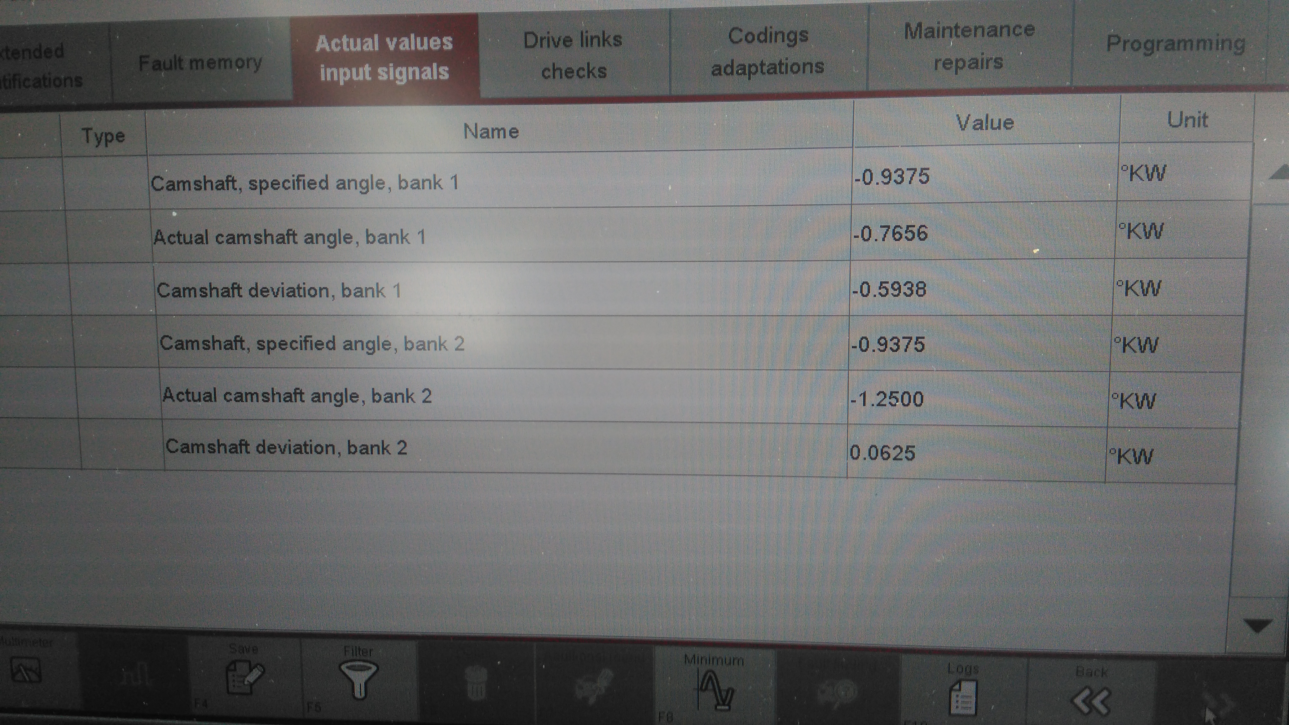

  10. Managed to use the PIWIS to cycle the solenoids and check the wiring. Alla seems good. No obvious damage. Bank 1 Specified -0.93725 Actual -0.7656 Deviation -0.5938 Bank 2 Specified -0.9375 Actual -1.2500 Deviation 0.0625

  16. In all of the three above, the difference between the actuals and the specified isn't the same as the deviations????? The deviations are staying at static values. I am Confused.
  17. A few more revs Bank 1 Specified -29.3594 Actual -27.0313 Deviation -1.2500 Bank 2 Specified -29.3594 Actual -30.2344 Deviation 0.1094
  18. With about 3000 revs Bank 1 Specified -23.3359 Actual -21.7188 Deviation -1.2500 Bank 2 Specified -23.3359 Actual -20.7031 Deviation 0.1094

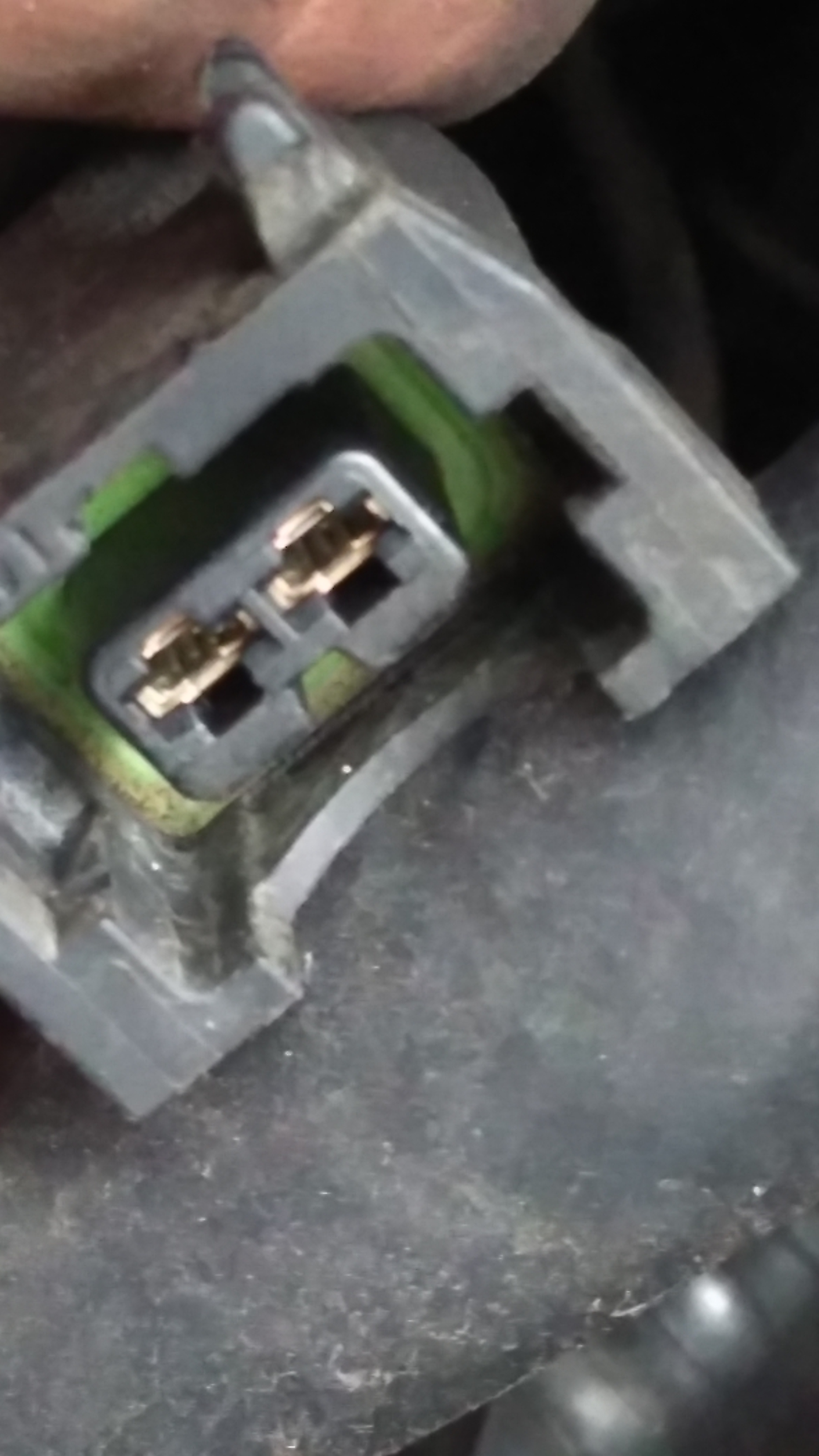

  19. Idle, both banks. Bank 1 Specified -1.0000 Actual -0.8281 Deviation -1.2500 Bank 2 Specified -1.0000 Actual -1.1875 Deviation 0.1094

  21. The connector. I didn't short the connector. Or check the resistance of the sensor. I've put it back together now.
