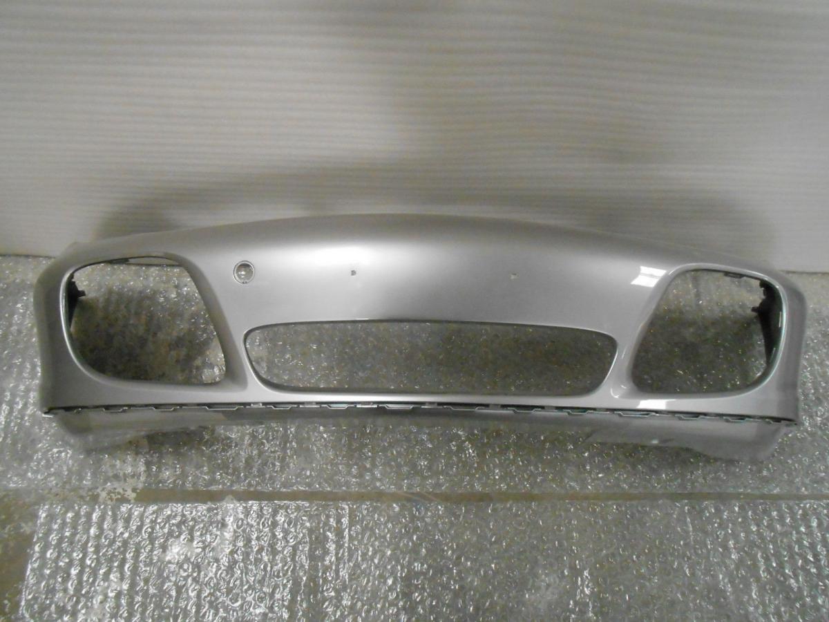

  2. I recently purchased a newer bumper cover for my 2001 Porsche C4 Cabriolet, I believe its a 2002 & up Turbo front bumper cover...I have heard mixed things that I will need to uses this bumper cover on my 2001 996, my question is... Do I need the 2002-04 headlight assembly or will my 01 headlights work with this bumper cover? Do you know what other parts may be needed to complete the facelift?
