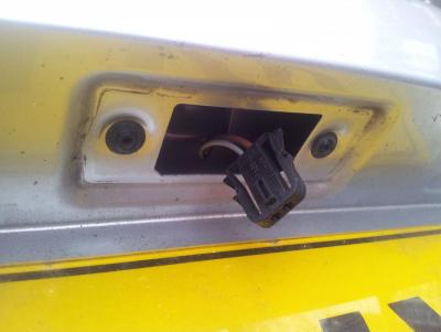

  5. I must be looking in the wrong place. I cannot see any ground on the rear light unit. Today, i looked at the number plate units again. Checking with the tester i can confirm the light units are both ok as i get a connection sound using the multi-meter however, when connecting the tester to the two wire on the car i get no reading when the car lights are switched on? its either bad earth or no voltage getting through.. any more pointers (sorry to be think!!) tony
  6. Hi loren, Any pointers where the ground is located? I took off the number plate lights and their are two wires on the plug that go onto the number plate light unit. All looks ok, no dirt, no rust, no damage.. Do i just test the ground wire from the plug, or is there a central ground for the rear control ? Thanks for any help
