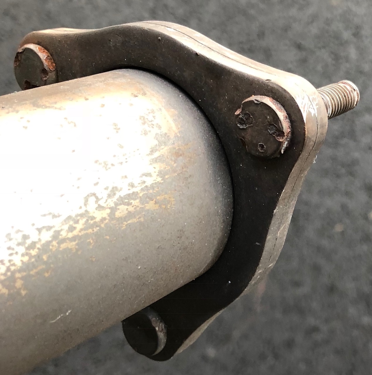

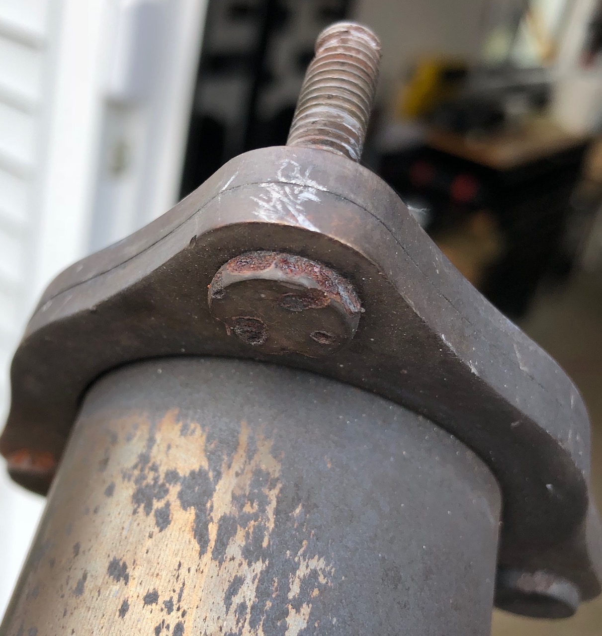

Catalytic Converter Bolts
leonidasb22 replied to leonidasb22's topic in 996 Series (Carrera, Carrera 4, Carrera 4S, Targa)
I bought a heavy duty large c-clamp and tried it. It didn’t work on my bolts. I then went to a machine shop and they heated and hammered them out for $20. Thanks everyone for your support on this issue. I'm so glad I got this resolved quickly. -
Wow okay RFM. Thanks for the info. Seems like you removed these bolts before. Is a hydraulic press easier or the torch and hammer is the preferred method? I may try to find a machine shop that would do it for me if the torch method is still difficult. Do you think a big steel C clamp could do the trick, without torching? -
The replacement Porsche bolts now have a hex head. -
See below -
