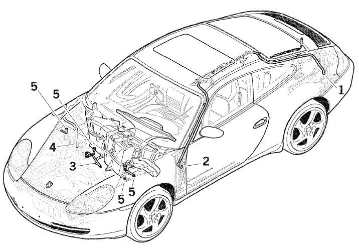

Regarding #3:
Be sure all your drains are clear and not obstructed.
Regarding #4:
http://www.renntech.org/forums/topic/39553-power-driver-seat/
