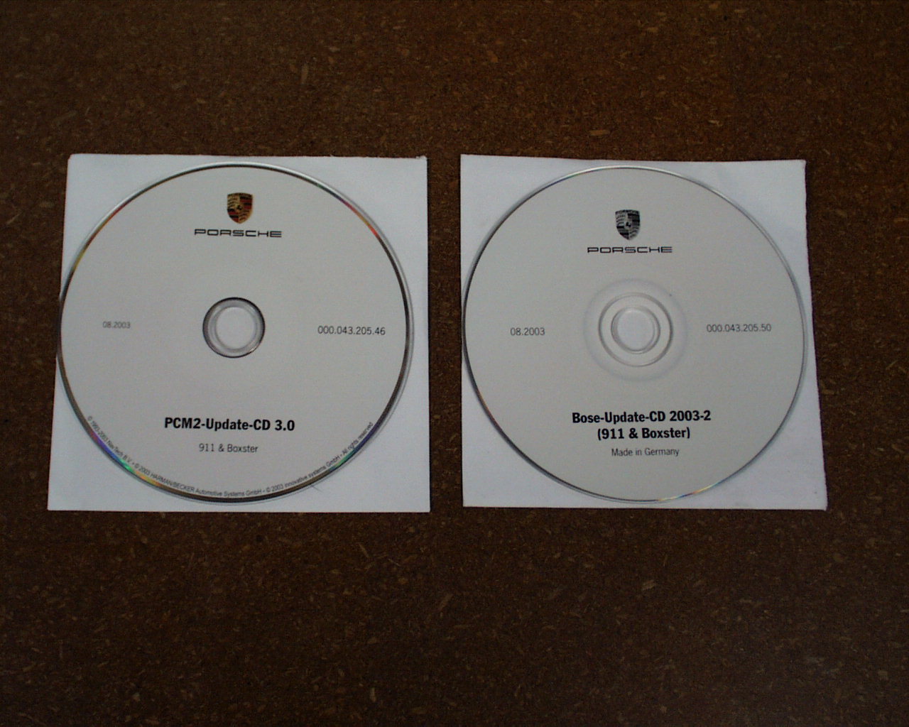

  1. Hi Loren; The Porsche-BOSE CD Rom software Update fixed the PCM2 code. Thanks for your help.
  2. Hi Loren; I have received these two CD Rom Updates relating to the TSB. I will let you know what happens.
  3. TSB 13/04 W522 Dated 04-15-2005 applies to this car. The PCM2 Software Version is 3.0 and the BOSE amp Software version is 000 119 20. The TSB indicates there is an update for the BOSE amp. I do not know if that will fix the Code 800A, but I suspect I should try. Does anyone have experience with this TSB ?
