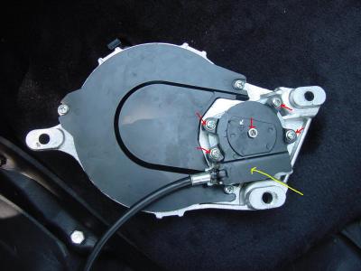

Mark: Well, that was the key but in a roundabout way!... Here is a photo of the half-moon gear in the transmission. From this postion, you have to spin the cable so that the half-moon gear is near the middle of its travel. Then, when you install the transmission and install the V-lever (with the 19mm bolt torqued to 59 ft/lbs) you don't have far to go to line up the V-lever with the marking notches . Here is a photo of the transmission showing the marking notches. The notches, in the way they are slanted, help you to make sure that you don't have the V-lever installed 180 degrees off. Without RennTech Forums, I was looking at a big $$ repair, (to say nothing of the feeling of accomplishment). :renntech: Regards, 1schoir. Hello, Sounds like you’ve grappled with a problem that’s vexed me for years. My Boxster was T-boned awhile back. The body shop neglected reattach some of the opening and closing mechanism (just as well I suppose…reading this thread) Question, in your half moon pic, do you mean that unlike the image, the half moon gear should be centered, that is, it would rotate equal distances cw or ccw before it hits it’s stop? And, at this point, the arm will be roughly in the proper position? If so, what position is the top in (I think you mention 12 in. form the windshield?) If all those ducks are in a row and the pushrods etc. are in place, should the top be good to go? Also, the micro switch, is their only one on the drivers side? Thanks in advance for your reply. It’s really great to find a place where Porsche people aren’t afraid to get there hands dirty + have the smarts! Thanks in advance. Peter P.S. PM me if you’d like. Peter: I noticed in your other post that you stated that you have a MY99. The first thing you have to determine is whether you have the original style transmissions (Version A). Porsche changed over to "Version B" in May of 1999. If you have the half-moon gears, you have the "Version A", early style transmissions. Unfortunately they are the more troublesome ones, but they can be made to work properly. In response to your questions: 1. The photo of the inside of the transmission showing the half moon gear shows the half moon gear before it has been rotated to its initial position, which is only used as a starting point. To get it to the initial position, you must temporarily install the V-Lever, making sure that the arms of the V-Lever are located in between the "marking notches", after you have seated the back of the V-Lever in the two slots provided for that purpose on the CENTER exposed section of the half-moon gear (after it has been re-assembled). Here is a photo of the marking notches with the V-lever sketched in: In this photo, you can also see the two slots that I am referring to, (although they may not be in the proper position of rotation). (Note: this is photo of psgr side transmission). Also, there are no "stops" for the half-moon gears. If they are out of adjustment, they will keep rotating, until they "pop" with a loud click or crunch. When all the pushrods are connected, if the half-moon gear goes past its last tooth, it goes off with that pop and then gets pulled back with the tension from the clamshell hydraulic pushrod, and then pops off again, and goes on like that until and unless you operate it in the opposite direction. 2. When you are in the initial starting position with the V-Levers in between the marking notches, the front of the convertible top should be positioned so that it is almost closed, between 2 to 12 inches from the top of the windshield. You will be able to assess this when you snap the white plastic ball cups (you may still have the earlier red plastic ball cups) onto the metal ball which is below the B-Pillar part of the convertible top frame. I found it easiest to dissassemble those pushrods at the middle, where they are held together by a 10mm bolt with a thick washer. Before you unscrew the 10mm bolt, mark the position of the front part onto the part that is attached to the V-Lever so that you have a point of reference. Once you press the white plastic ball cup onto the metal ball, you can then re-attach that front part to the part that is attached to the V-Lever and you should then find the front of the convertible top in the correct position. 3. There is only one microswitch in the B-Pillars, which is only on the driver's (left) side on the MY 97-99. On the later cars, or the ones where the transmissions have been replaced with the Version B transmissions, the microswitch is in the psgr (right) side transmission. Make sure to also first verify that your drive cables are okay, as that is usually the initial cause of all of the problems on the cars with the early style transmissions. You have to pull the cables out from where they are inserted into the sides of the motor. Just pull the small metal clip upwards and pull the cable out. Then verify that you have 3/4" of the inner metal (speedometer type) cable sticking out. If you don't have that much sticking out of the outer black plastic sheath, the inner cable (when inserted) will not be engaged and the motor will not spin that side to rotate the transmission. You also have to make sure that the inner cables have not become "unwound" or broken apart inside the black platic sheaths. If you spin each metal cable by inserting it in a drill (lowest torque setting), you will be able to tell if it's operating the transmission because the half-moon gear will rotate. There is an excellent post by Tool Pants, with photos and a procedure for repairing or replacing the cables. All of this should give you a place to start. Let us know how you progress or what roadblocks you run into. Regards, Maurice. -
Any competent body shop can generally tell if a car (Porsche or not) has been involved in a major collision that reults in frame damage. A "repaint" would not necessarily result in higher thickness readings. A proper repaint involves sanding down the finish, which will remove several mils of thickness before re-applying either color coat and clear coat(s) or primer, primer-surfacer, sealer, then color coat and clear coat(s). A paint meter can be a useful tool, but I would not rely on it exclusively. Regards, Maurice.
First place to start is definitely by checking to make sure that both of the drive cables (on the side that goes into the motor which is in the center, under the clamshell, just forward of the third brake light) are sticking out of their black plastic sheaths by 3/4". You can check them by pulling off (up) the small brass clip that is holding each metal ferrule end into the side of the motor. If either one is not sticking out or sticking out by less than that, that cable may not be able to be inserted or stay inserted into the motor's drive on either side of the motor and therefore will not operate the convertible top transmission on that side. Depending on what you find, you may able to repair the cables or you may have to replace them. Look at this thread for a detailed explanation by Tool Pants, with photos on this issue: http://www.renntech.org/forums/index.php?s...pic=68&st=0 What year is your car? Do you have the old style (97-99) transmissions ("Version A" in the factory manual) or the newer style ("Version B") or a combination of the two? Could you describe what specific steps you took when you followed the manual and what results/symptoms you got. Are you referring to using the "marking notches" with the V-Levers positioned in between those notches as a starting point? If both sides appear to be operating in the opposite direction from each other as you describe, is it possible that you installed one of the V-levers 180 degrees off. With the keyed cutouts, it is possible to install the V-levers in only two positions: either the correct way or 180 degrees off. Regards, Maurice.

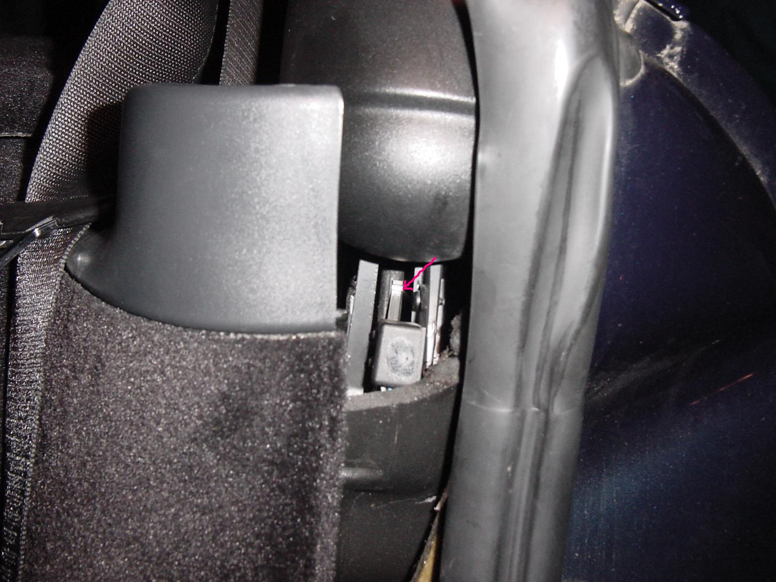

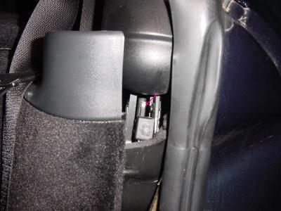

Thanks for your detailed response. I saw the switch but I thought it was a seatbelt switch, seeing how it is right next to the seatbelt... I will hook everything back up and watch the leveler in action. I spent 4 hours yesterday evening trying to figure it out and I still can't get it back to the way it was. Both sides still pop now. I took out the two pushrods and just left the clamshell connected for a semi-automatic operation, at least for the time being. I needed to get away from it and start fresh. My patience is running very thin with this project now and I don't want to do anything I might regret later. Is this micro switch activated only when the top goes up? The relay seems to be OK, although you never know. I'll take it out and shake it up a bit to see if it gets any better. The alternative is to knock at my neighbor's house, who also has a Boxster, and ask if I can borrow his relay... But that's creepy, I don't even know the guy! Thanks again, Julian. Julian: The microswitch is tripped when the top reaches very close to the end of its travel when it is almost closed. Again, there is a black arm that rotates up in conjunction with the pivoting of the round bottom of the B-pillar part of the convertible top mechanism. That black arm presses on the small metal lever part of the microswitch forward and the small metal lever presses on the microswitch to trip it. If you use a small L-shaped pick or a small L-shaped allen key, you can pull the small metal lever forward until you hear the relay click in the footwell. There were a couple of posts by Tool Pants where he said that tapping on or shaking up the relay after you remove it sometimes "fixes" it. So, definitely give that a try. The neighbor option doesn't sound creepy, it doesn't hurt to ask. Who knows, he may have some questions about his Boxster that you can help him with. Just make sure his car is either a MY 97, 98, or 99. The later relays are different. BTW, you have to pull pretty hard to get the relay out, but there are no clips or anything else holding it in. If you want to start from scratch again as far as the position of the V-Levers go, take a look at some recent posts I made which show where the V-levers go in relation to the "marking notches" on the housings of the transmissions. I posted a couple of photos with the V-levers drawn in. If you can't find them, let me know and I will hunt them down. I do know that one cause of the white plastic joints popping off is that the V-levers continue to rotate past the point where everything is snug (i.e., the forward edge of the top has reached the windshield or the top is completely open and the clamshell snug up on top of it). That is why I suggested that you try to "back-off" the V-levers in one direction or the other. Try not to get too frustrated. Look at it this way... After you resolve this problem, there is nothing you will not know about how the top operates and you never have to worry about getting stuck with your top open or closed again. Some proof of this is that you are now easily able to make it work in the semi-automatic mode, etc. , whereas you probably had no idea how it all worked before. Not necessarily a choice you would make, but sometimes these cars don't give us the choice. Regards, Maurice. One more thing I forgot to mention. If you look at the photo of the mircroswitch that I included in my post #27, you can see the black arm that rotates up. If you blow up the photo, you can see that black arm just behind the small metal lever that the red arrow is pointing to. Also, just to the right of the small metal lever you can see the side view of the small black screw that holds the microswitch in place. Regards, Maurice. -

Hi Maurice, I did not replace the top main relay. I also did not replace the B-pillar microswitch. Do you have a picture of this switch? How do I get to it? If it was a problem with either one of these, don't you think the light wouldn't go out at all? Right now the light does go out, but the driver's side pops... It seems more like a mechanical problem than electrical, but at this point I am willing to try anything. If you have any pictures of the top relay and the B-pillar microswitch I would appreciate it. Update: I tried moving the top with the drill as suggested, reconnected, put everything back together, and now both sides pop. I tried to go back to the way it was before but I haven't had enough time to get it back (I did this on my lunch break). I will try later tonight to see if I can get it to where it will (sort-of) work... What a royal pain this top turns out to be! I may just rip it all out and get me a big-ol' golf umbrella to keep in the car just in case it starts raining. Thanks again, Azzar0. I know how you feel about wanting to rip it all out... The top main relay for MY97-99 is part # 986-618-111-02. It is located at the upper part of the driver's side footwell, in a relay tray that is locate above the fuse panel. You can't miss it because it is a double relay and is much larger than all of the other relays in that tray. IIRC it's the one that is one over from the right, third row up from the bottom. (Note: the first row on the bottom has no relays plugged in to it). The B-pillar microswitch part # is 986-613-101-02. The B-pillar microswitch is located near the top of the carpet-covered semi-round long plastic trim panel that is just behind your left shoulder as you sit in the driver's seat. To access it easily, you must remove that piece of trim by unscrewing the phillips screw which is hidden in the pile of the carpet, about three inches from the bottom and 3/4" forward of the engine firewall. Then loosen by 2 turns (DO NOT REMOVE) the 8 mm bolt that is located (on an angle) just forward of the front driver's side carpet pad on top of the engine cover. Then you can manoeuver the piece of trim off and you will see the B-pillar microswitch near the top, just below the big plastic "knuckle" at the bottom of the B-Pillar part of the convertible top mechanism. Here is a photo of the microswitch: The red arrow (click on the photo to enlarge) is pointing to the small metal lever part of the microswitch. The microswitch housing is the little black plastic box just below it. (Note, in this photo, the trim panel has only been pulled aside and has not yet been removed, to give you a reference of where the microswitch is located). As the top closes, there is a black metal arm that comes up along with the B-pillar (which is actually pivoting at that point) and that metal arm presses on the small metal lever part of the microswitch, which in turn presses on the tiny switch encased in the black plastic box. As the small metal lever is pulled forward, it presses on the switch and you can hear the relay in the footwell clicking. If that metal lever is bent out of shape, it will either trip the switch too soon or too late, but there is no adjustment possible of the relay body itself, only in the bend of the small metal lever. As far as the likelihood that the problem is probably mechanical, I tend to agree but can't be positive because that main top relay is one complicated piece of electronics. The fact that your light still goes out is a good sign from the relay. Since you mentioned that you spun the V-levers as I suggested and that now caused BOTH white plastic joints to pop, why not try to rotate the V-Levers a little in the opposite direction (i.e., after you get them back to your original position where only one pops, go a little further in the opposite direction than the one you first tried and see if that solves it.) Keep us posted. Regards, Maurice. -

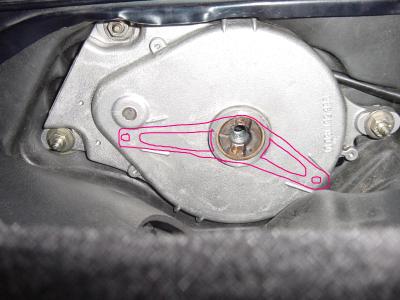

Tom: When you take the transmissions apart again, before you put the black plastic covers back onto the backside of the transmissions, if you hold the V-lever against the opposite side and spin the transmission so that the V-Lever is located in between the "marking notches" (as in the photo in the link above), you will find that the half-moon gear is engaged and not far from their starting point. Also, make sure that you snug up the four screws (plus the nut on the fifth one in the middle) that hold the smaller plastic cover on top of the worm gear. Apparently the black plastic cover compresses over time and the screws, even though they have not backed out, end up loose. That sometimes causes the worm gear to skip and will eventually throw the timing off. Looking forward to see how you make out. Regards, Maurice. -

Tom: Take a look at the "marking notches" on the outside cover of the transmissions. The V-Lever arms should be in between the notches. Of course, you already know that there are two cut-outs on the part of the half-moon gear into which the 19MM bolt gets screwed into. So, unless you are 180 degrees off, the V-Lever can only be bolted on one way. Take a look at post # 12 in this link for a photo of the marking notches with the V-Levers drawn in red: http://www.renntech.org/forums/index.php?s...amp;#entry75978. Note that you will have to remove the V-Levers again so that you can press the foam liner back in place (because you can't see the marking notches with the foam liner in the way. But, once you put the foam liner back in place, line up the V-Levers with the cut-outs and they will be in the same exact position as you had them with the foam liner off (i.e., in between the marking notches). When I did mine, with the transmissions off and opened up, I just set the half-moon gear at the beginning of the 50 teeth and then, by spinning each cable with a drill, I moved each of the V-Levers so that each one in turn lined up between the marking notches. Let me know how you make out or if you have any further roadblocks. Regards, Maurice. -

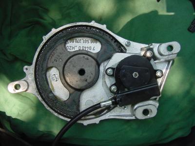

Mark: Well, that was the key but in a roundabout way! I was not making any more progress until I could figure out what was causing the V-levers to spin in only one direction no matter which way the Up/Down button was pushed. It turns out that the B-pillar microswitch is what can be used if the motor will only spin in one direction. If you pull back the carpet-covered plastic panel on the driver's side B-pillar, you can see how that microswitch operates. It's sort of the opposite of most microswitches in that it will set off the relay when it is pulled (all the way) up. When the top is almost closed, just prior to latching, there is a piece on the bottom knuckle of the convertible top rear hoop that serves to pull up that microswitch. So if you ever have a problem with the top only operating in one direction no matter which way you push the button, just slip something around that microswitch lever and pull it forward and you will hear the relay at the driver footwell click. When it does, press the up/down button again and it will now operate the V-levers in the opposite direction of rotation. You were partially correct with your observation that the V-levers might be bolted in the wrong way. More accurately, after I put the V-levers in line with the marking notches as in the V-levers that I sketched in, and hooked up the black push rods and the rod arms with the white plastic cups to the V-levers and the bottom knuckle of the top, I was still not able to operate the top in both directions. It would only get to a certain point and then the switch would either die or operate in only one direction. The key turned out to be that the half-moon gears were actually the part that had to be rotated 180 degrees and at that point the V-lever had to be flipped upside down so that it fit between the marking notches. At that point, I hooked everything back up and voila, the top worked perfectly and the clamshell followed along perfectly as well. I think that by rotating the half moon gear around, it ends up somewhere near the middle of its 50 teeth and thus does not "fall off" the worm gear which is turned by the cable. Here is a photo of the half-moon gear in the transmission. From this postion, you have to spin the cable so that the half-moon gear is near the middle of its travel. Then, when you install the transmission and install the V-lever (with the 19mm bolt torqued to 59 ft/lbs) you don't have far to go to line up the V-lever with the marking notches . Here is a photo of the transmission showing the marking notches. The notches, in the way they are slanted, help you to make sure that you don't have the V-lever installed 180 degrees off. Here is a photo of the B-pillar microswitch with the red arrow showing the little metal lever arm that must be pulled forward if your top only operates in one direction. I was able to do the installation that finally worked with the top 2/3 of the way closed (about 12 inches from the windshield). At that point, I first hooked up the white plastic cups onto their ball joint, and then connected that part of the rod arm to the part that is already on the V-lever by means of that one 10mm bolt and thick washer. Then, after hooking up the end of the black pushrod with the clip to the clamshell arm, I maneuvered the clamshell so that the other end of the black pushrod could reach and be pushed firmly onto the ball joint on the rearmost part of the V-lever. I then did the same to the driver side and made sure the V-levers were in the same relative position on each side and that the clamshell was level when looking at it from behind. I also measured from the rear ball joint on the V-Lever to the bottom of the side rail (in which the lowest part of the clamshell arm slides back and forth in a sliding plastic cup) on each side and got about a 4 inch measurement (by taking a page of how the manual says to measure with the newer style transmissions (Version "B"), just to make sure the V-levers were synched. I then pressed the button to open the top and everything worked! This is the first time since I bought the car that the top has worked in the automatic mode and the former owner told me that it had not worked in "a couple of years" before I bought it from him. From what I have been able to learn and observe, it seems that this all started with one of the cables stretching and everything went downhill from there. I want to express my gratitude to especially to Mark in Sunnyvale, to Tool Pants for the posts in the archives, to $Chris in NH and to Azzar0 for their invaluable help in getting this done. Without RennTech Forums, I was looking at a big $$ repair, (to say nothing of the feeling of accomplishment). :renntech: Regards, 1schoir. One more note. For those of you experiencing the "back and forth cycling" as the top gets near its fully closed position (as described in my first post on this thread), that is caused by the B-pillar microswitch being tripped and "untripped" by the part that presses on it (at the bottom of the black knuckle of the B-pillar frame member of the convertible top). I haven't figured out how to adjust it so that it happens exactly when the top reaches the maximum closed position, so I may just replace that microswitch. Regards, 1schoir. -
