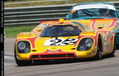

  1. Thanks for your interesting input. You made us think about the oil - we're going to look at some other options here as a precaution. After doing quite a lot of research on the net and speaking to various people, I think it makes sense to turn the revs down to around 6750. We DO really race this car! It's an awesome car with loads of potential, but we need to get the reliability sorted. Our engine builder is a very good Porsche man, but this twin turbo set up we have is something of an unknown quantity. We've had the car a year but because we've been busy with other racing, we only got around to racing it in January. We ran it once when we got it, but it broke rockers then and we basically rebuilt everything after that. We've now installed a Turbosmart wastegate and boost control unit to take care of the overboost problems, too. We're really trying not to upgrade everything at great expense - I would much rather run it at a lower maximum rpm and keep it reliable. I have attached a pic of the car - it really is a beauty!
