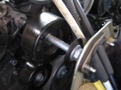

  23. Others may have a more experienced answer, but from what I've read here (and on other boards) this symptom usually leads to a failing ignition switch - the electrical part on the back side of the key. You might search on this and find an easy (and inexpensive) solution to the problem. Take care, Ed
  24. He got it out - bent the sheet metal :clapping:
