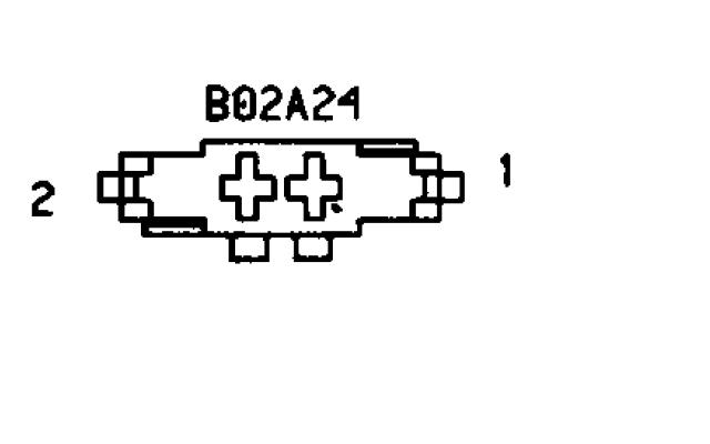

  12. How do you find these articles???!!!???? I do searches all the time and get tons of lists or nothing pertaining to what I need. Maybe I'm just not searching the way I need to. Thanks for the link. That sheds some light on the picture. I guess mine was removed and a third-party actuator for my DEI Viper alarm system. I guess now I know that plug has to do with the trunk actuator and nothing to do with the spoiler....which leaves me with still unanswered questions about the spoiler. Thanks again TP!!!

  15. Will: From the diagram that Loren posted at 8:32 p.m. on your "Rear Spoiler Comes Up at Speed" thread, it looks like the mystery connector is the one that goes to the "Tailgate Opener", as that one in the diagram shows the exact wire colors that you describe (i.e., a red wire, and a blue wire with a black stripe). What do you think? Regards, Maurice. yeah, that's it. THANKS!! I didn't see the colors denoted on the schematic. Thanks again! -Will
  16. Maurice, you're right!!! DUH!!! I went back and looked at the diagram. I didn't notice it earlier. Thanks for your help

  20. There is a cable not hooked to anything in the rear trunk of my '00 2.7L. Anyone know what it goes to? I looked up the connector in the Bentley and it is connector B02A24 - See Below

  22. I replaced the spoiler retraction relay. Still does not work. the dash light stays on. the spoiler goes up at speed, but does not go automatically down. I have to turn off the car and then turn back on and manually lower the spoiler. Anyone have any ideas?
