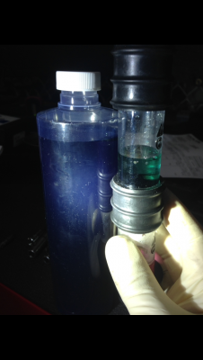

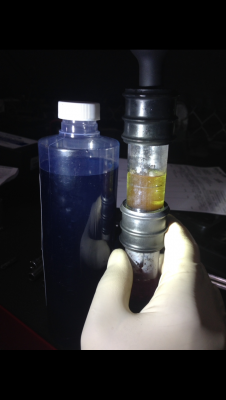

Thanks for all the info JFP. I was able to stop by my mechanics today because he told me that he noticed that his head gasket testing machine had bad liquid in it the first few times he tested the car before the reservoir replacement. So I stopped by today so he can check it with the newer liquid and sure enough the liquid changed from blue to a green that was close to the blue the first time, and then when he tested a second time it changes from blue to an almost yellow color, which he told me indicates that its most likely a head gasket issue. I will post pictures to show you exactly what came up. He gave me an estimate of about 2,000 labor and another 500-1000 for parts, depending on what he finds. My question to you is, why was there no indication of this from the oil that my mechanic recently changed? Would it not show up in the color? Why when the car was pressure tested multiple times did everything come out fine? Im very depressed from hearing this news today and am literally looking for any kind of direction from anybody on here on where to go from here? Is this liquid test a clear indicator that I have a head gasket problem for sure? And why do I smell coolant when I put my windows down when driving on the highway. Any feedback would be greatly appreciated! Thank you.
