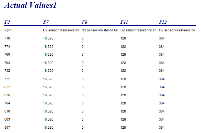

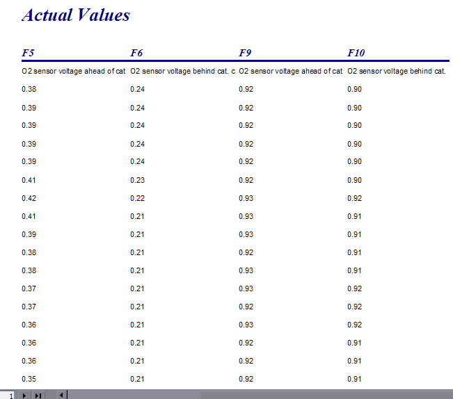

  2. What is O2 resistance showing? the O2 itself? F7. and 8 are bank 1, and F11/12 are bank 2. The second graph are of the voltages both sides.

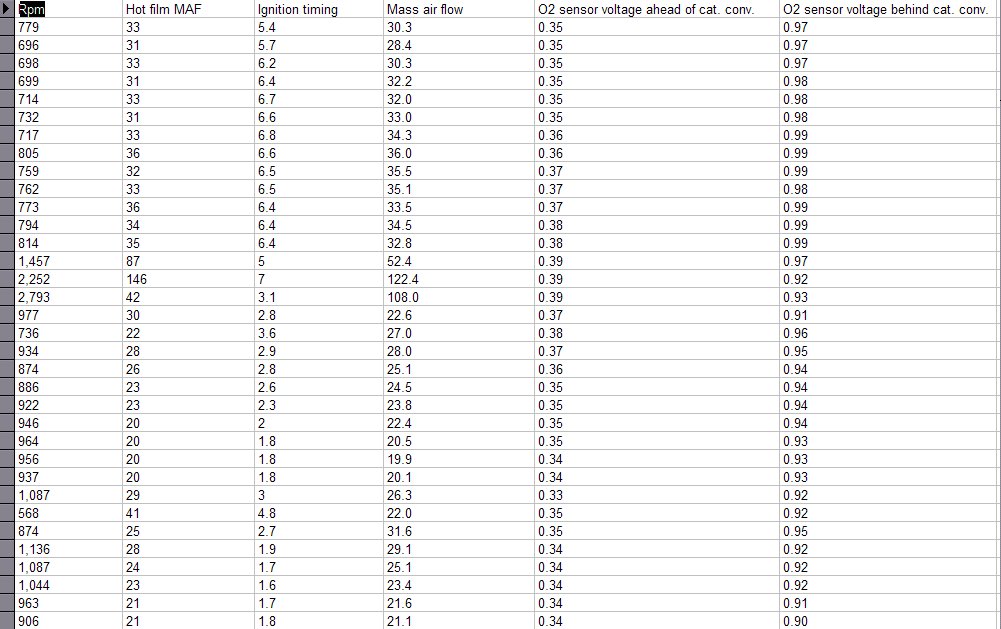

  3. My main concern in the graphs Loren is that I do not want to run lean and not sure where I am at this point with the O2 voltages as my guide?
  4. Are both of these from the same sensor and which side is it? Left standing at back of car. And is it possible to test by swapping cables on O2's? Added some data of my Custom supercharger at idle from the duramatic realtime log. Note the before and after readings on O2's conv.
