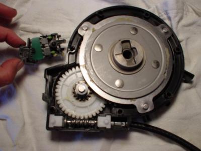

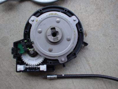

  3. I have only worked on one new style transmission. I was able to pull the inner drive cable (square end) out of the worm gear with my fingers. On the old style you need tools to pull the inner cable out of th drive gear. If you want to "glue" the cable so it will not accidently pull out you can clean everything with brake cleaner and use loctite.

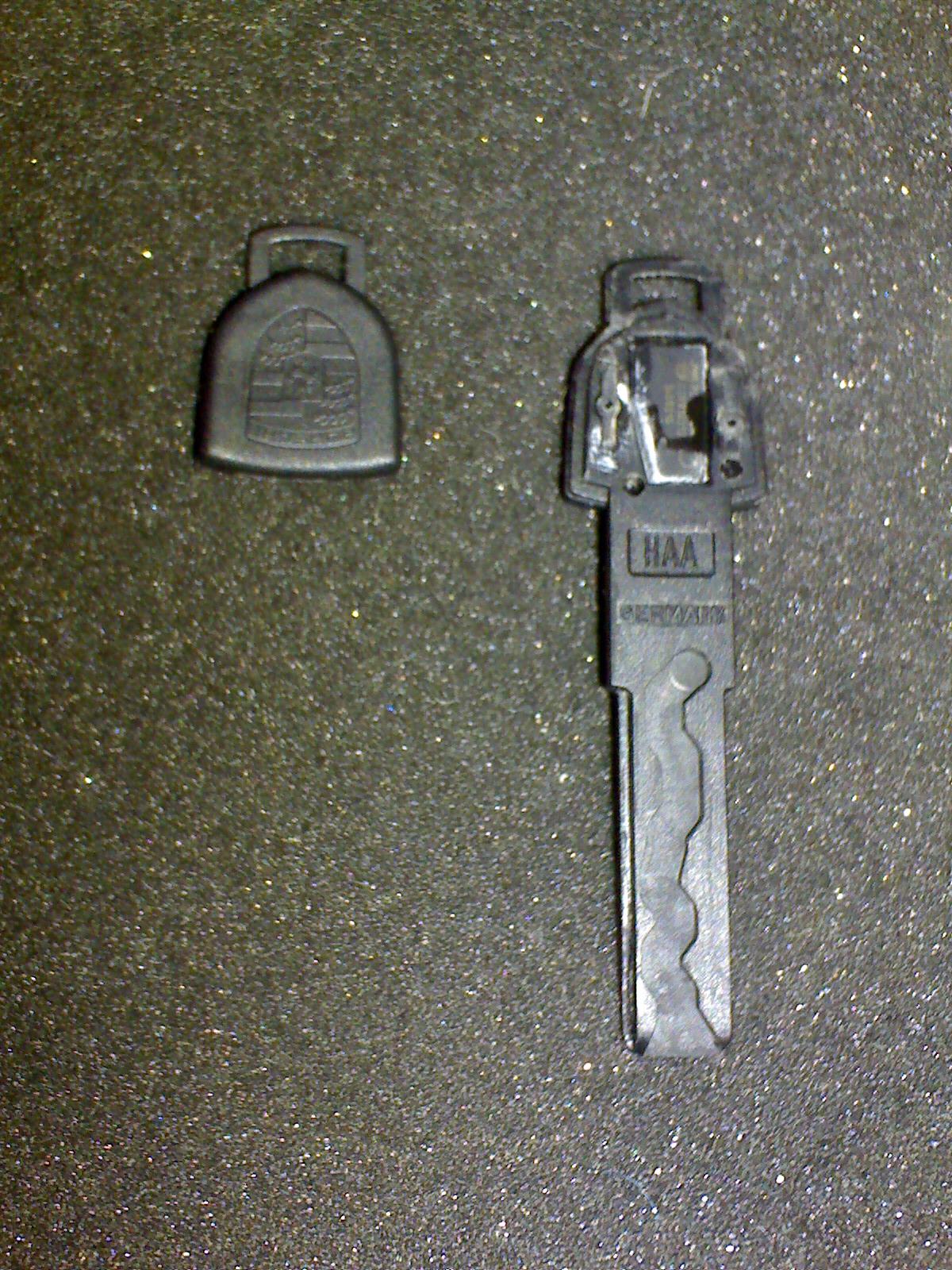

  4. Here is a picture from Popolou on Boxa.net of the plastic key. All that should be in there is the "pill" and I don't think water can bother it.

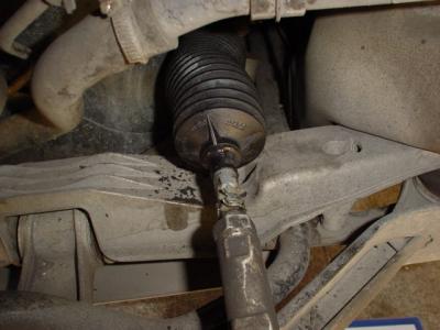

  8. In my case the seals in the steering rack are leaking, so I have to top up very few months. This has been going on for years, until I get around to replacing the rack. But only one time have I seen fluid on my garage floor. The fluid leaks into the boots, and I guess the fluid comes out of the boots when I'm driving. Take a front tire off then remove the small clamp from the boot to see if thre is fluid inside the boot.

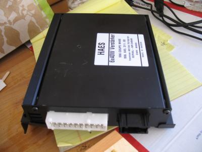

  20. Don't know of any reason you cannot use this. It comes back as a coupe, also used on a 2002 996. One of the local owners,Ray, has the same amp but has not put it in yet. That one should have a white connector.
