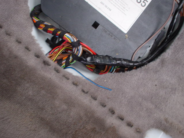

  6. I am very rusty on this. But when we put in that mirror or a Traffic Pro we had to find the reverse signal wire. Is that what you are looking for. Pic is from a 2000 2.7.

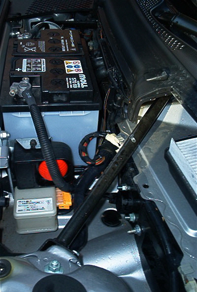

  8. No clue what is inside the unit, as we do not have this alarm feature in the US. But on the UK boards they say there are problems with water getting inside due to its location next to the battery. I thought the solution was to relocate it to a dryer place such as under the seat.

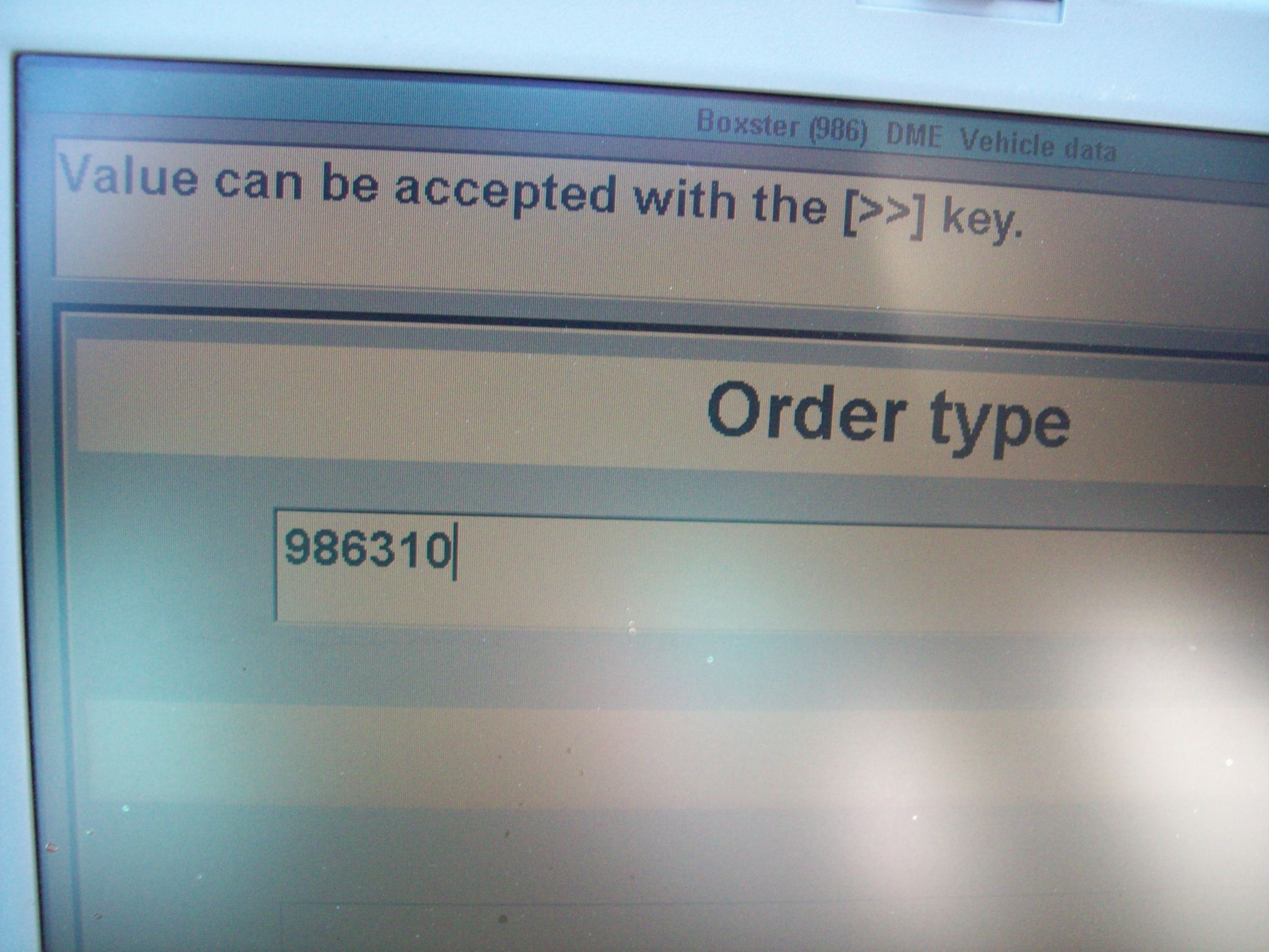

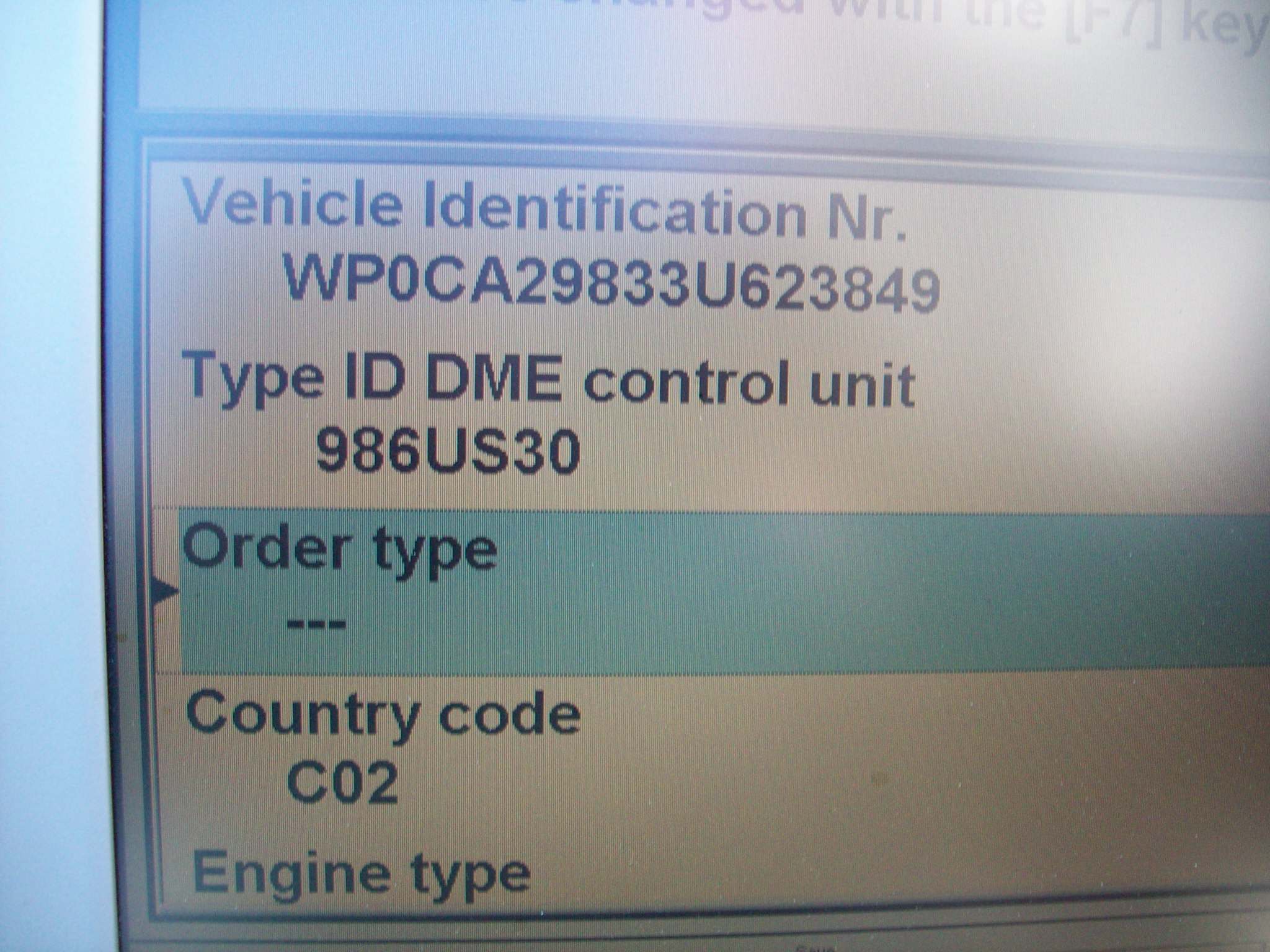

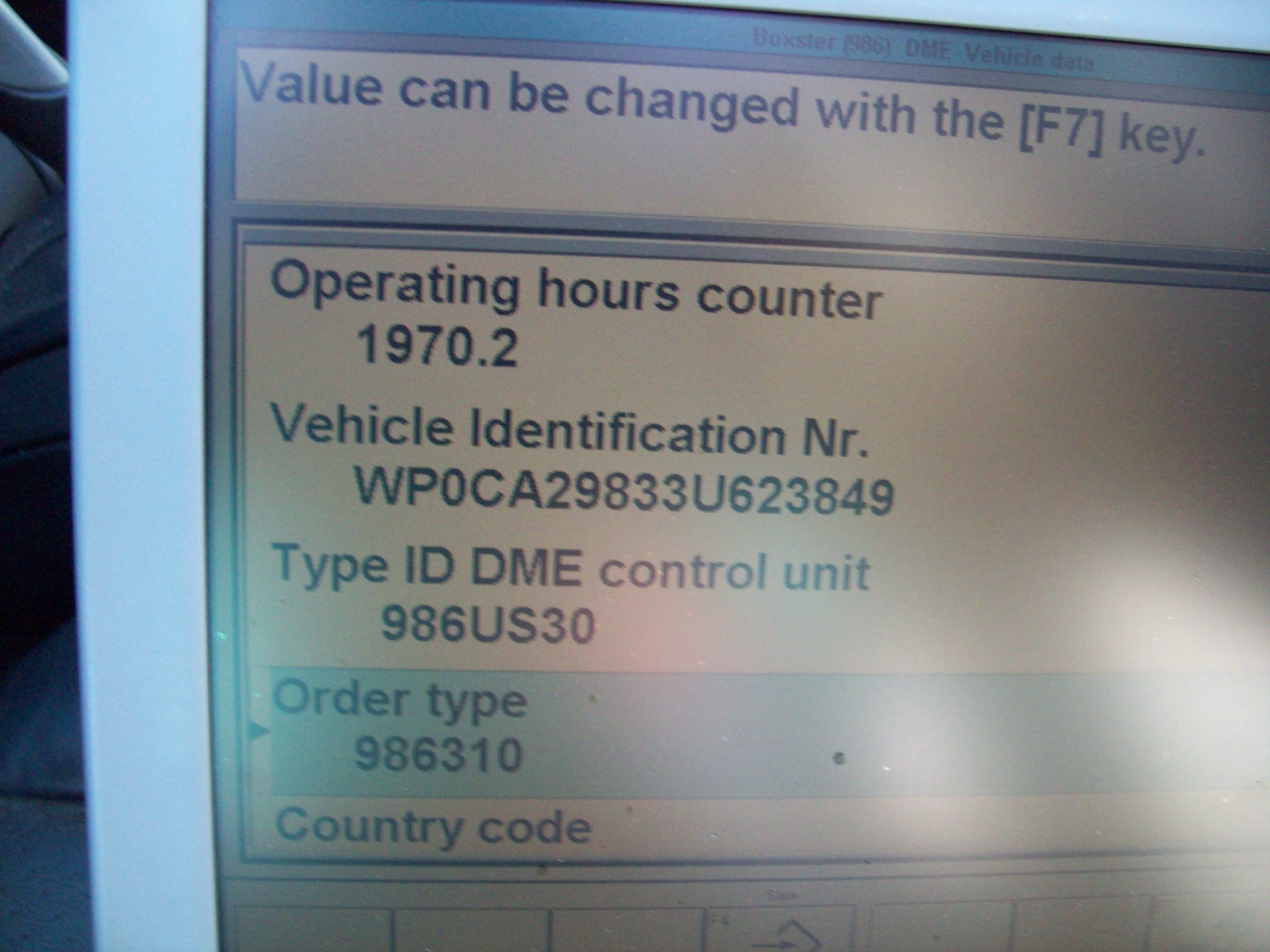

  15. I have not kept up on what a Durametric can or cannot do Never used one so I so not know what you can see with it.. Unless you have a very, very early 2003 you do need to put in the order type in the DME before you can modity the instrument cluster coding to with OBC. Keep in mind the order type is in the DME Once the order type has been entered then you cannot go straight to the instrument cluster to change the coding to with OBC. You have to start the automatic search all over again to scan all the control units. Then you can go straight to the instrument cluster and change the coding. When the coding has been changed the instrument cluster will go dark and then turn on. You will hear a gong sound. The trip odometer will go to zero. But this is with a PST2.

  17. A UK car has an siren with it's own internal battery that sounds off if you disconnect the battery for the car. It is the black thing with the round red grill. Below that is the tilt sensor. We do not have this in the US. On a UK car you are supposed to turn the ignition on before you disconnect the cables from the car battery, or the siren will go off. Don't know why that procedure is not working for you. I have heard that the siren is very loud....
