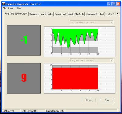

  12. I was unable to get a sensor snapshot of the engine readings when the error code occurred, but I have been able to verify that it is only the P1123 that is tripping the CEL. I have attached the fuel trim settings per your instructions. They show about 30 seconds of idle, peppered by one or two engine revs just to see the difference. Thanx again for your help. I am approaching a smog test in CA, so you can imagine why I want this resolved particularly quickly. Any help is appreciated.

  14. After resetting the CEL, I finally (again) got a CEL signal, and it is P1123 again. I did go in and look at the characteristic of the O2 sensor, and it DOES indeed vary rapidly between the two threshold voltages you mentioned. I still have not observed a P1125 error, and the RPM is at 700 steady. I have attached my MAF readings obtained via the Digimoto unit used to monitor OBD II. Any suggestions for how I might go about narrowing the problem? I DID try dipping the MAF in isopropyl alcohol and replacing, to no avail.......
