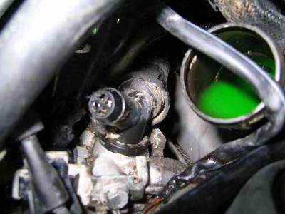

  21. The Bank 1 cam position sensor is at the rear of the head (car rear, most accessible), but I haven't seen how bad it looks when the engine is in the car. The other bank's is at the front of the engine. Sensor for Bank 2 is located in the back of the engine, behind PS pump above cylinder #4.

  24. There is one sensor for each bank.
