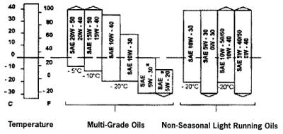

  10. Great post. Given that Mobile doesn't make a 5W50 motor oil, do you think that Castrol is still very reputable? Since it does get pretty cold up here this time of year, I'd feel more comfortable using at least a 5W, particularly if I make weekend ski runs up to Vermont where it can get very very very very cold (I've skied in -25 degree F weather). Thanks. I run either Castrol or Mobil. Both are good oils.
  11. Exactly. Maybe you should call them up and let them benefit from your knowledge. Cheers, Uwe They probably would benefit from someone elses knowledge. However, the primary reason for the confusion is that people DO NOT read correctly. Porsche DOES not recommend 0W40 in there engine at all times but simply state that it is approved and trhat it is the factory fill. As a matter of fact, below is an excerp from one of Porsches' TSB's. Viscosity The viscosity of an engine oil is specified by the SAE viscosity class. The first number and the letter W (winter) identify the viscosity at lower temperatures. For example: 0W or 5W, where 5W is more viscous than 0W. The second number indicates the viscosity at higher temperatures. For example: 40 or 50, where 40 is less viscous than 50. Multi-grade oils are identified by both viscosity specifications. For example, SAF 0W40 or 5W40 or 5W50. Examples: 0W40 and 5W40 oils have the same viscosity at higher temperatures, however, at lower temperatures, the SW oil is more viscous. 5W40 and 5W50 have the same viscosity at low temperatures, but at higher temperatures, the oil having viscosity class 40 is less viscous. Temperature Ranges Above -12°F. (-25°C): all oils approved by Porsche for the vehicle type to be considered Below -12°F (-25°C:: all oils approved by Porsche for the vehicle type to be considered which have the SAE class 0W at lower temperatures. Keep using the 0W40 in hot climates and we'll continue this conversation when your valve guides wear out along with the main crank bearings. So why the sudden change in "approved" oils?. Why was the factory fill for the 3.4 engine 15W50, yet some say you HAVE to use 0W40 now? Did the engine internals change? Did Porsche originaly make a mistake? Is the "approved" list compiled of the biggest contibutors? There is NO benefit, whatsopever for using 0W40 versus 5W50 or 15W50 when you are in temperatures above 20F. This is not conjecture, but fact. There ARE, however. substantial benefits for using 5W50 or 15W50, which incude less shearing at high engine temperatures, longer adhesion to engine components, less evaporation, less oil usage (for those of you who are burning oil). Even Mobil 1 says that the 15W50 is a great oil: Mobil 1 15W-50 is our most advanced performance synthetic engine oil designed to provide ultimate wear protection for a smooth driving experience every time. Mobil 1 15W-50, Performance Driving Formula, exceeds the requirements of the industry and car manufacturers' standards required for high-performance turbo-charged, supercharged gasoline and diesel multi-valve fuel injected engines. Mobil 1 15W-50 is a winning race proven technology. It is especially suited for high-speed highway, towing, and other severe service situation. Mobil 1 15W-50, Performance Driving Formula, provides extra engine oil performance and protection for the winning edge. Mobil oils are the official oils of NASCAR. So, unless you can somehow make a 0W40 oil protect my engine better than a 15W50 oil at engine temperatures above 230F, I think I'll stick with my uneducated and ignorant decision to use 15W50.
  12. I wouldn't run the 15W50 this time of year in the NE. However, the 50W in the summer will provide you with significantly more protection on the 3.4 engine because the engine runs extremely hot. 15W50 is what I use, but would not shy away from using 5W50 either. It is the 50 that will protect you more from shearing the oil at high temps. Porsche has no idea what they are doing with their oil recommnedations. As a matter of fact, they do not make any recommendations anymore, but simply give you a list of "approved oils". Many, many dealers will fill your crankcase with 15W50. The fact is, a 15W50 oil flows the same as a 0W40 oil all the way down to 14 degrees and a 5W50 flows the same all the way down to -20F.

  17. 1999porsche911: I live in Southern California. Temperatures range from 65 to 110 year-round. What oil would you recommend I use? I currently run on factory-fill 0-40W Mobil 1 Thanks. Personally, I would run 15W50 all year round. There is no need to go with an oil that is "pourabe" at -60F. You will be fine, also, running 5W50 but the oil has more additives in it to maintain the higher 50W rating. This really is not a problem if you change your oil at regular 5,000 miles or less intrevals. Castrol Syntac makes both weight oils. Are you going through as much oil in the hotter months as you do gas using the 0W40?
  18. Remove the MAF and spray liberaly with electronics cleaner you can get at an ACE hardware store. Put it back in. Remove the intake tube to the throttbody and open the butterfly valve slowly, all the way. Spray liberaly with carb cleaner. Reinstall intake tube. Reboot computer by removing negative battery cable for 2 minutes and then reconnect. You're done. It will take a few drive cycles to get your idle back to being smooth.
  19. What is the protection? Do a little research and you'll see its not for shear strength which is what you need in a high reving, high temperature engine. But, I have no stake in what people use, but have rebuild a few dozen engines that used low viscosity oils. They are not pretty. If it doesn't cause all your seals to leak so you have to replce the engine, you have a good chance seeing the downside of the 0W40 when you get some high miles on the car. Valve guides in particular, along with main bearings. But, to each their own.
  20. You know, I really never understand it when someone puts up a post with a tone like this on a forum dedicated to the friendly sharing of information and insight. Maybe RennList .... but not here. Of course, we all have differences of opinion on many, many subjects .... the right tire, exhaust system, ride height, etc .... but, on some subjects, concrete, authoritative information is fairly easy to come by. Porsche's latest TSB on approved oil recommends the Mobil Synthetic 0W40, as does my dealer (for my 3.4 engine) for any ambient temp .... which probably covers Miami year round. On the other hand, the TSB .... as far as I can find, does not recommend any 10W40 or 15W50 oils under any circumstances. The bold print in the Engine Oil section of my Owners' Manual says, "if in doubt, consult your authorized dealer", so I guess its OK to trust him on this. However, I find no fault with, and have no argument with anyone who chooses to go another way. Porsche approves many different oils, both manufacturers and weights. Finally, I guess I must misunderstand what the TSB says regarding viscosity: You recommend chucking the 0W40 in favor of the 5W40 or 10W40 for the Miami winter ... presumably because those south Florida winters are warm. But, all three of these oils will have the same viscosity at higher temps; the only difference coming into play at an ambient temp below -12F. At that point, the 5W40 would have to be swapped out for 0W40 if a new ice age came to Florida .... and the 10W40 could only be used if one chose to ignore Porsche's latest info. As always, I stand ready to be educated and corrected in my never fully adequate understanding of these wonderful machines and their mysteries. You guys will surely let me know if I've failed Properties of Oil 101. Kim 2000 Cab I didn't know I was so harsh wth my reply, but after readings it again, I see where someone might take it that way. Oh well. As fas as Porsche TSB's on approved oils, it is not a recommnedation to use 0W40. That is only an aprroved oil. We all know (or should know) that a 0W40 oil will not protect an engine that normally runs an oil temp in excess of 230F. Furthermore, people have come to believe that becasue 0W40 is the factory fill, that is a recommendation from Porsche to use it in all climates. It is not. In past TSB's Porsche specifically outlines what weight oil to use in all climates, and in Florida's climate, the suggested weight IS NOT 0W40. The chart below has existed for 30 years. What changed? Maybe just wanting to get a litlte better short term performance out of the engine or a little better gas mileage? The oil didn't change. It still is not certified for any temp above 212F. Our engines run considerably hotter than that.
  21. I know that the 996 has cartridge oil filter and therefore no valve on the filter, but it must have a way of keeping the oil up in the engine. Yes, lifters... I use 0W-40 Mobil 1 and am located in Miami Florida, so most always is over 70F. Stop using the 0W40. Move up to a 5W40 or 10W40 in the winter where you live. Only someone intent on destroying their 3.4 engine would run the 0W40. I won't even run that crap here in Chicago and it's currently 17 degrees outside. In the summer, you should move to a 15W50. Porsche DOES NOT recommend 0W40 in your climate.
