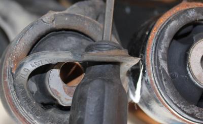

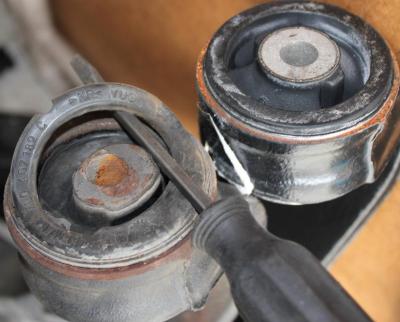

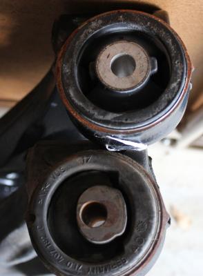

  21. Replaced mine with the Turbo S pieces. Here are some pics. I'll add a warning for anyone else who wants to tackle this. You must remove the nuts on the control arm prior to moving the bolts. What I mean by that is the bolts that hold it to the frame (the bushing side) have a groove cut into them to position the eccentrics on the "nut" side. And the eccentric washer is one piece with the bolt on the head side. So if you were to loosen it on the bolt side, because it's easier to get to, it will damage the adjuster. I almost did just that based on the experience with other cars where the bolt was just a bolt, or the eccentric was the bolt itself in the middle. All in all I think it took me two hours to do both sides working at a leisurely pace. I used a "pickle fork" to separate the ball joint but be warned that it may push up against the brake dust shield by doing so. No damage to mine but something to be aware of if you don't use a jaw-puller. This was on the easier side of things I've done on this particular car. After putting the adjusters back where the stock arms were set, I had it aligned and the toe was the most significant change. In the pics, the piece that is being held up by the screwdriver was visible while still on the car so I knew that side (passenger) was bad. The other side is the one with the tear in it so bother were due for replacement. I have about 94,100 miles on mine. Next up is to deal with another squeaking/chirping blower motor gone bad after two years...
