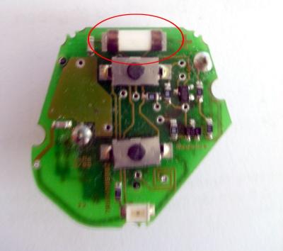

  15. No M536, only options are 232 396 454 490 502 535 551 582 688 692 Update: I made the connectors match and put in the used M534 unit with 433 Mhz in the car. The doors did not open or close with the keyfob; i was only able to open the trunk lid - the same like with the other old M535 unit. The only different thing that happend is that both windows went down when i pushed the keyfob. Then i changed the keyhead with the M534 platine (see picture) and i could go to ignition, but where not able to start the car. My "old" key had the little "glass pill" (? transponder/immobilizer ?) on the side, the "new" key from the used M534 unit had it on the top (i guess - red circle?). Then i installed the old M535 unit back again, changed the key back and the car started, but no door locking, unlocking with the fob. The guy i bought the used unit from told me, that it worked fine bevore he remode it. So - what should i do? Does the M534 unit only needs to be programmed? When i first went to the Porsche dealer, they took a lock at the car and said it might be the doorlock itself. Then they put it at the computer and then said, i would need a new unit. So - what should i do next? If there´s nothing else left that i can do by myself, i guess, i would bring the car to the dealer and have a new unit installed. And it´s not only the money. I would like to solve the problem by myself (with the help on renntech, of course) :renntech:
  16. But i have the matching 433 Mhz keyfob with the immobilizer. I just need to cut the connector so that it fits inside the module. Should this work?
  17. Sorry, i forgot to mention - i´m from Germany. Over here, it makes no difference if you use 315 Mhz or 433 Mhz. I thought, the 415 MHz might also work with my US specs Boxster. Just plug´n play...
