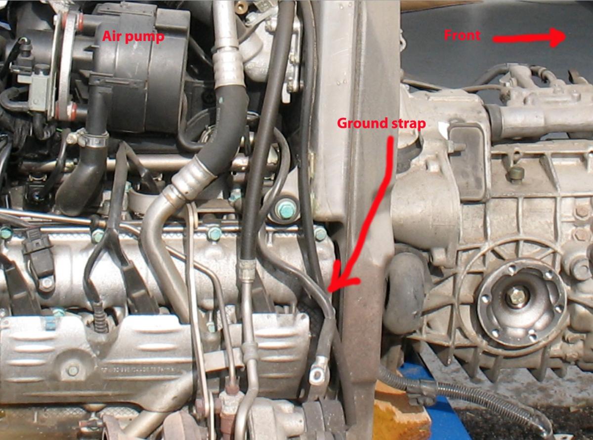

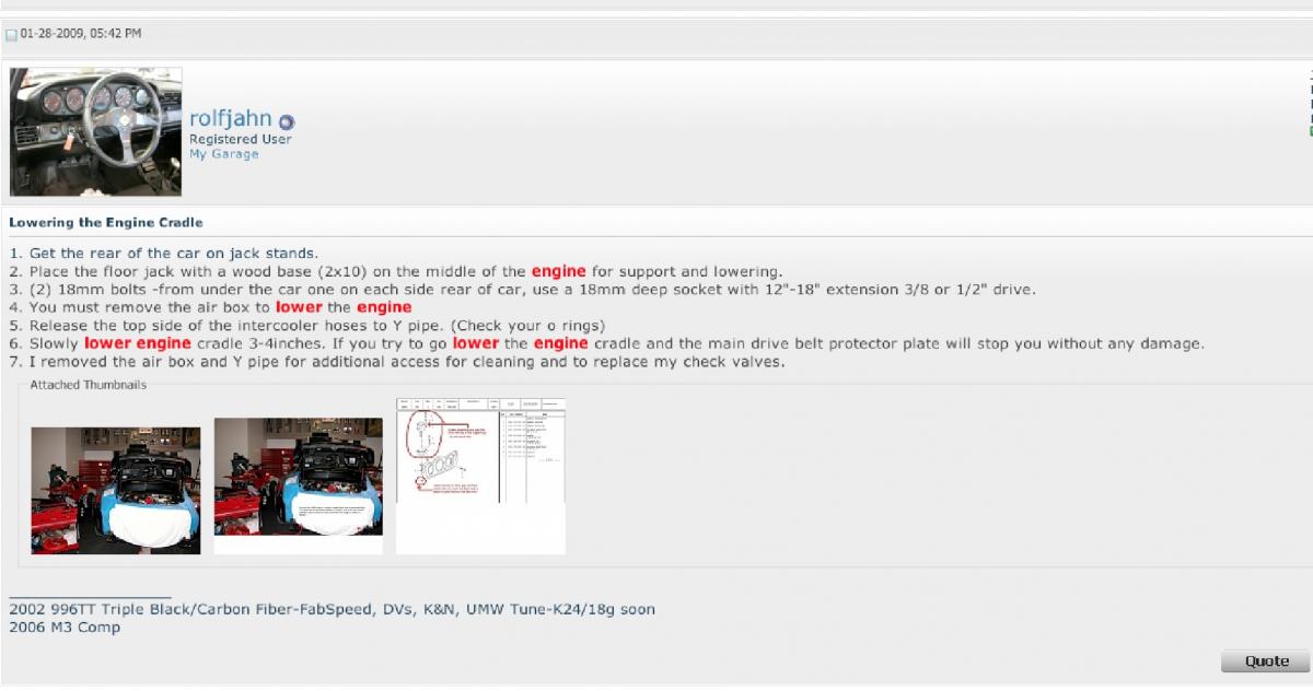

  1. Here's a view of the ground strap with the engine remove. I think JFP is talking about this one...(correct me if I'm wrong). The frame attachment can be seen above the right turbo and the other end is beside the fuel pressure regulator just under the air pump. I think it is possible to reach and to facilitate the job you should lower the engine about 4 inches .... Lowering the engine is easy especially if you got access to a floor jack. See attachment.... I did not read all your post on Rennlist and 6speed but have you check the power consumption at rest which is suppose to be .6 amps maximum ? Secondary air pump removal can be seen in the repair manual page 641.

  24. Just found a picture in my collection of TT pics and the other end of the ground wire is only a bolt to the engine block just aft of the engine oil reservoir. It must be difficult to reach because it is in front or the air pump.....
