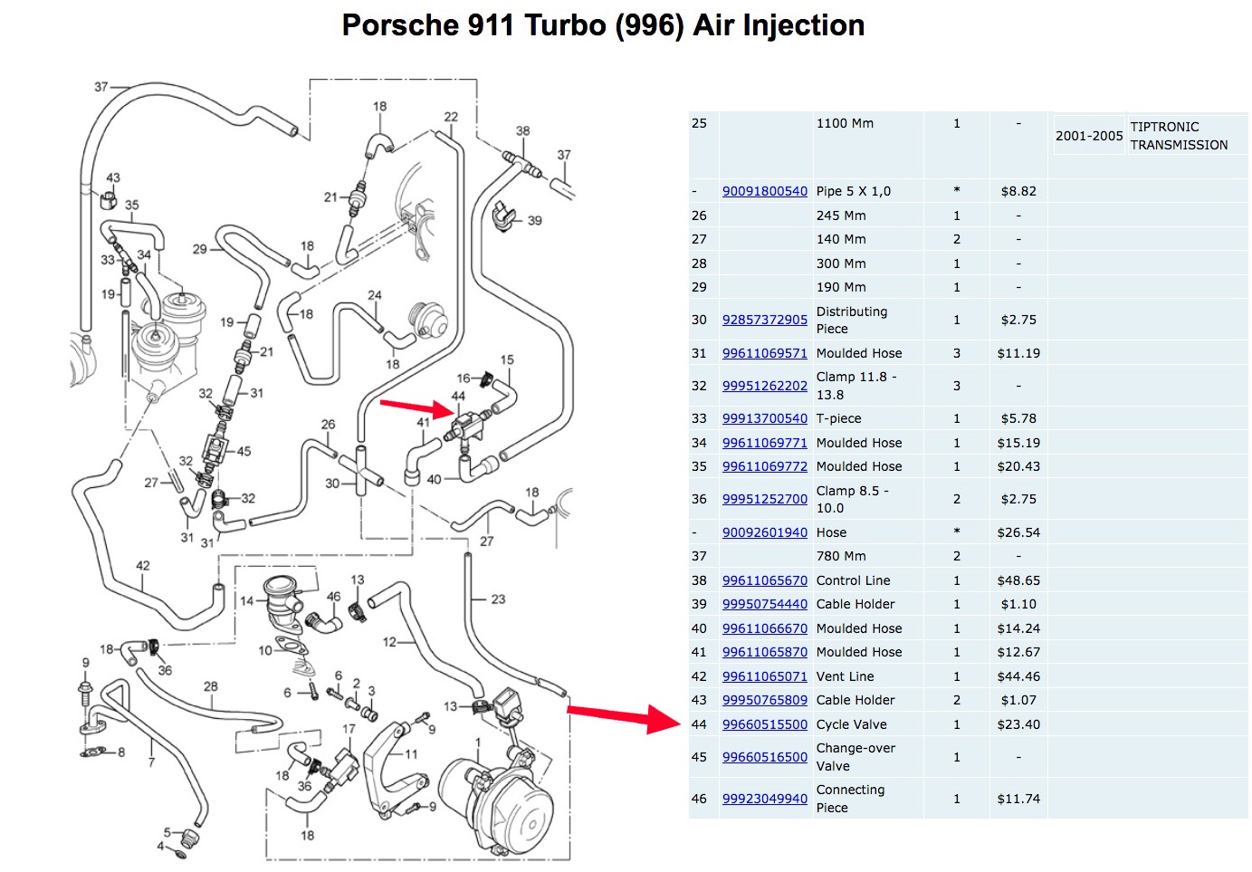

  11. If you follow the vacuum line from the cycle valve (N75)#44 you will see it split in two #38 (near the top of the oil tank), and goes to the waste gate on both side. I cannot answer your question about the term N75 because the first time I've learn of the existence of this term was on the TT forum....I used it after 😉 No experience with Audi.... One day a guy came to my place with overboost problem and I immediately went to this cycle valve and found it disconnected from the intake...
  12. This is the valve that control the waste gate and it is sometimes called the N75. The parts catalog call it the cycle valve and the part# is 996 605 155 00

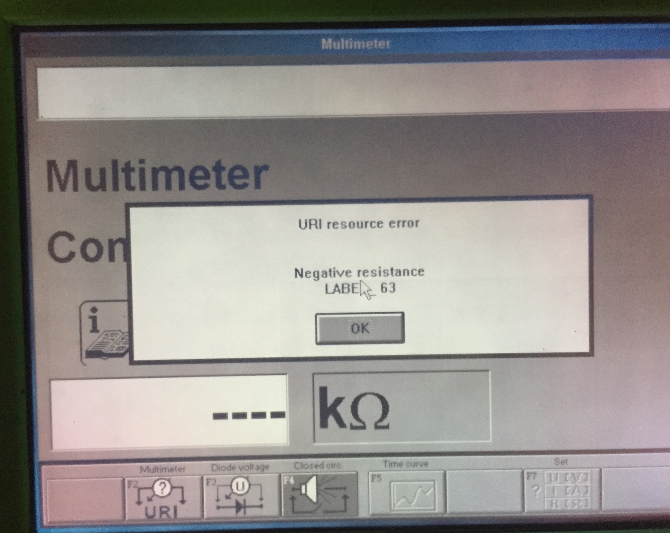

  16. I've receive an answer from a PST2 sellers and specialist on Ebay, Mike, and here's his answer about this error message with the PST2.... "That error is because the URI hardware module does not have the porsche special firmware; the firmware needs to be updated. I would not worry about it, since you're better off testing resistance with a hand-held multimeter. Some users burned out or damaged the motherboards when they tried to test continuity on live circuits, and unlike the PIWIS testers, the PST2 does not have fuse protection."

  19. Finally, I was able to figure out the breakout box wiring and I did the test of the internal multimeter" Voltage work fine but I always got an error with the resistance function....Any clue?

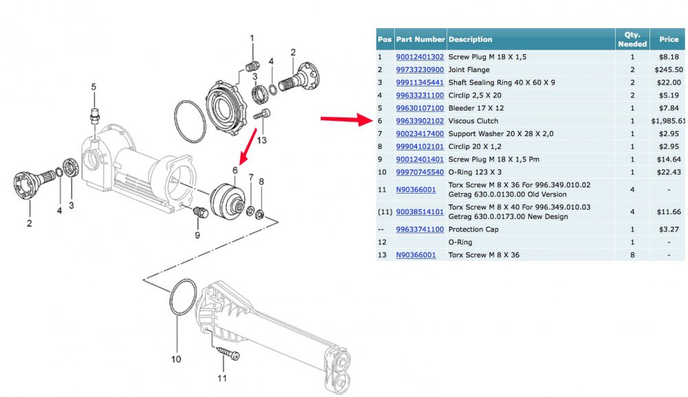

  20. At 90,000 miles Porsche recommend to replace the front differential oil. But the all wheel drive on 996 turbo got no controller as such. It is a viscous coupling. Viscous clutch on the parts catalog item#6. This viscous coupling is sealed and no maintenance is required....

  25. Yes I purchase the box from this Ebay seller on your first post...Last week I did some research on different Bosch sites and unfortunately the KTS500 is now too old and there is no more support for it. Thanks for this breakout box link! I will contact the seller...What I wanted to do with the KTS was to test the internal function to see if the tool is working properly, the multimeter, ohmeter, voltmeter (called URI)... Previously I was working with a clone PST2 which is a Dell Latitude C610 (still have it) and the multimeter functions are not available with this laptop. Voltage or resistance reading was dome with a Fluke but being from the old school I was curious to see how the real tool was used... The years go by and I don't get any younger 😉 I no longer work on cars other than mine except for a few PPI ... My TT is not used much less than 1000 kilometers annually, and does not give me any problems . But I have two grandsons who love this car and I would like to introduce them to mechanics with the tools that were used at the time. Later they will fight among themselves to know which will have the car for the weekend LOL !!! Thanks for your help!!! J.P.
