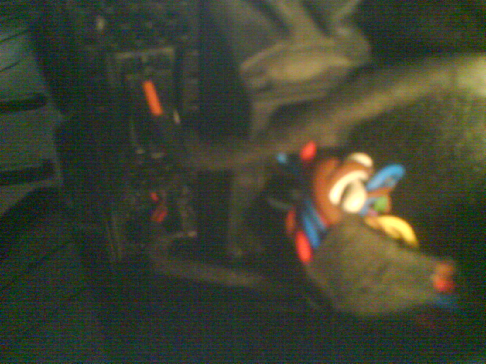

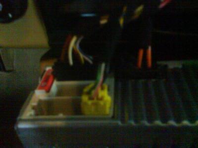

  12. The first pic is the rear of stereo CDR 23. The Most is the two orange wires. The second pic is the Bose amp (you still can notice the Most orange wires).
  13. As I can't post pics by PM, here are two pics of CDR23 rear panel and bose amp. The orange wires are the MOST.
