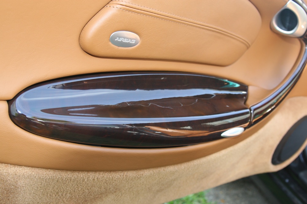

  6. success!! somewhat. ok, it's taken 3 months of tinkering, but i think that i have a solution. i don't know if anyone else had this problem or not, but here is what i did: after removing the top panel from the armrest, i drilled about 20 small holes in the back. with a hypo, i injected clear hobby cement (modeling glue) into the holes. i can't even remember how many tubes i used. could have been as many as 10 to 15. i just did a little each day and kept doing it until the top didn't flex anymore. then, i sanded the top and sprayed 3 coats of clear polyurethane, wet sanded to 1200, 3 more coats, sanded, 3 more coats, sanded. the problem i had was: now the wood grain look was gone where i had done the repair, so i took the finish almost completely down to where i started. i took an air-brush and blended in some dark ebony stain to simulate the wood grain color that was there originally and then went through the finishing process again. buffed it out and this is what i got. i know it's not perfect, but i can live with it. don't know if it was worth it, if you are just counting the dollars and time, but i learned a lot and hopefully someone else can use it too.

  9. i had a problem with the cover of the storage compartment cracking. don't know exactly what caused it. i decided to just buy another compartment door. retail: $1100 :o sale price: $785 :o when i looked inside the compartment, i noticed that the cover of the door is attached by 13 small torx screws. i removed the cover and will now attempt to save a little cash and repair the original one. does anyone know what the clear finish on this part is made of? epoxy? urethane? as i get it done, i'll post pics and hopefully it will help someone else as well. thanks

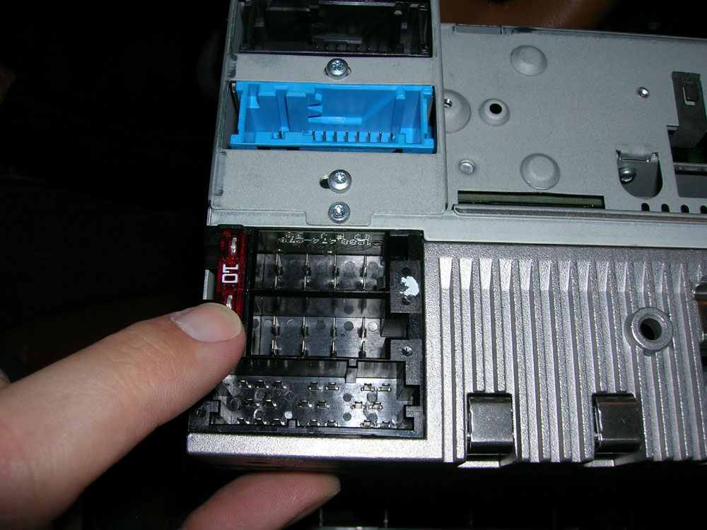

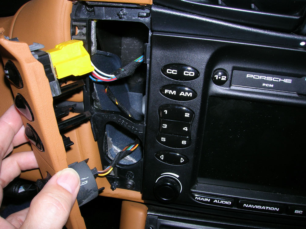

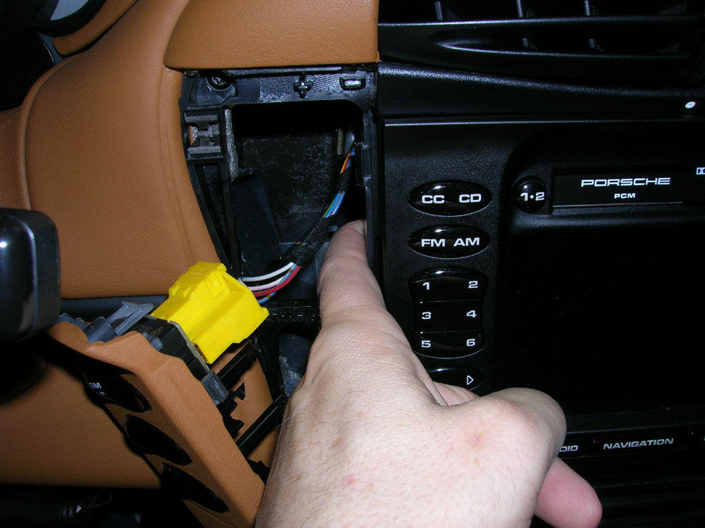

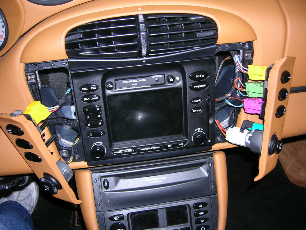

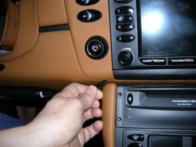

  21. i got it!!! this cured my pcm1 problem, but i don't know if it is the same for the pcm2. here is what you do: 1) remove the left and right switch panels from the side of the pcm unit. you do this by inserting a small spatula at the base of the panel and prying upward. you can see in the photo that i used the metal stereo removal tools. they work fine. just be careful not to scratch anything. as the bottom releases, use your fingers to pull the remainder of the panel loose. 2) repeat for right side. there is no need to disconnect any of the switches or cigarette lighter. 3) there are 2 metal spring tabs that hold the pcm1 in place. insert your index fingers on each side of the unit and push these in. while holding them in, slide the unit toward you. here is the location of the spring tab w/ the unit removed: 4) once the unit is free, there is a 10amp fuse located on the driver's side upper rear corner. you should be able to reach it without disconnecting all of the wiring harnesses that plug into the rear of the pcm. i did not know what i was looking for, so i removed the entire unit. i removed the fuse and tested it to find that it was open. i replaced it and reinstalled the pcm. you will have to enter your codes again, so you might want to have those handy. i don't know why only the sound system is fused. i would have thought that the entire unit would be. anyway, glad i found it. hope this helps.
