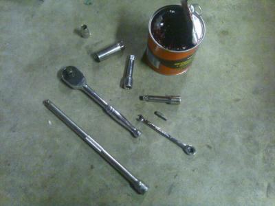

  3. I just finished my spark 3rd spark plug job on this car. First try took me 6 hours, second try took me 4 hours, third try took me 2.5 hours so I wanted to share some tips on how to speed up the process (I did not have to remove the bumper or the exhaust) ATTACHED IS THE PHOT OF THE TOOLS I USED: - the wrench is used with conjunction of the 5mm bit, the closed end turns so it works like a rachet (this combination allows you to get into the tight spaces) - the grease is for lubing up the spark plug so it wouldn't get stuck in your spark plug when you're taking it out - the long extension is for reaching the 2 plugs on the left and right side of the car closest to the wheel - the 2 mini extensions is for you to get to the other 4 hard to reach plugs, put the spark plug socket and the extension in first and then attach the 2nd extension and finally the rachet - the 10 mm socket was used to remove the heat shield TIPS - only the rear needs to be jacked up to access the spark plugs - the spark plug closest to the rear end of the car on the DRIVER'S SIDE can be reached through the exhaust gap at the rear of the car - if you can not get your hand at the proper angle to loosen the screws or gain leverage try positioning your body at a different angle underneath the car (ie instead of vertical, try horizontal in relation to the car) - make sure you double check all wire connectors connecting to the coils to ensure the wire is secure and COMPLETELY on - check to ensure all the spark plugs are the correct model before installing PROBLEMS - do not over lube your spark plug, just use enough lube so it doesn't get stuck to the spark plug socket - ROTTEN EGG SMELL, MISFIRE, I ran into this issue after replacing the spark plugs and I ended up redoing the whole spark plug job to fix it, I probably did not connect a wire properly to the coil - MORE VIBRATION THEN NORMAL, again check the spark plug wire to the coil to make sure it's secured I hope these tips are imformative! Please feel free to email me or msg me on AIM if you have any questions. GOOD LUCK!!!
