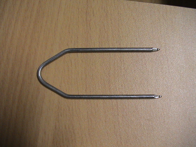

  3. Here are the pics of the tool.

  5. valcax, on the left and right side of the 8bit computer in your car, there are two plastic caps. You have to remove them. It should go with your fingernails. Behind the caps there are two holes on each side of the computer. The tool has to be pushed inside the two holes. The tools look like the letter C, it unlocks the computer so that you can pull it out. I will make a picture of the tool and the nav computer with the caps removed.

  7. Yes you can buy it at your Porsche dealer. The part number is 996.642.122.03. There should be no problem changing the nav computer. You just need a tool to get it out. It is a Blaupunkt tool, also used to remove standard Blaupunkt radios. When you get it out pull out the plugs and insert them in the 16bit computer. That's all. You perhaps will have to reenter the code after switching on the navigation. The code is sold together wit the new 16bit computer.
