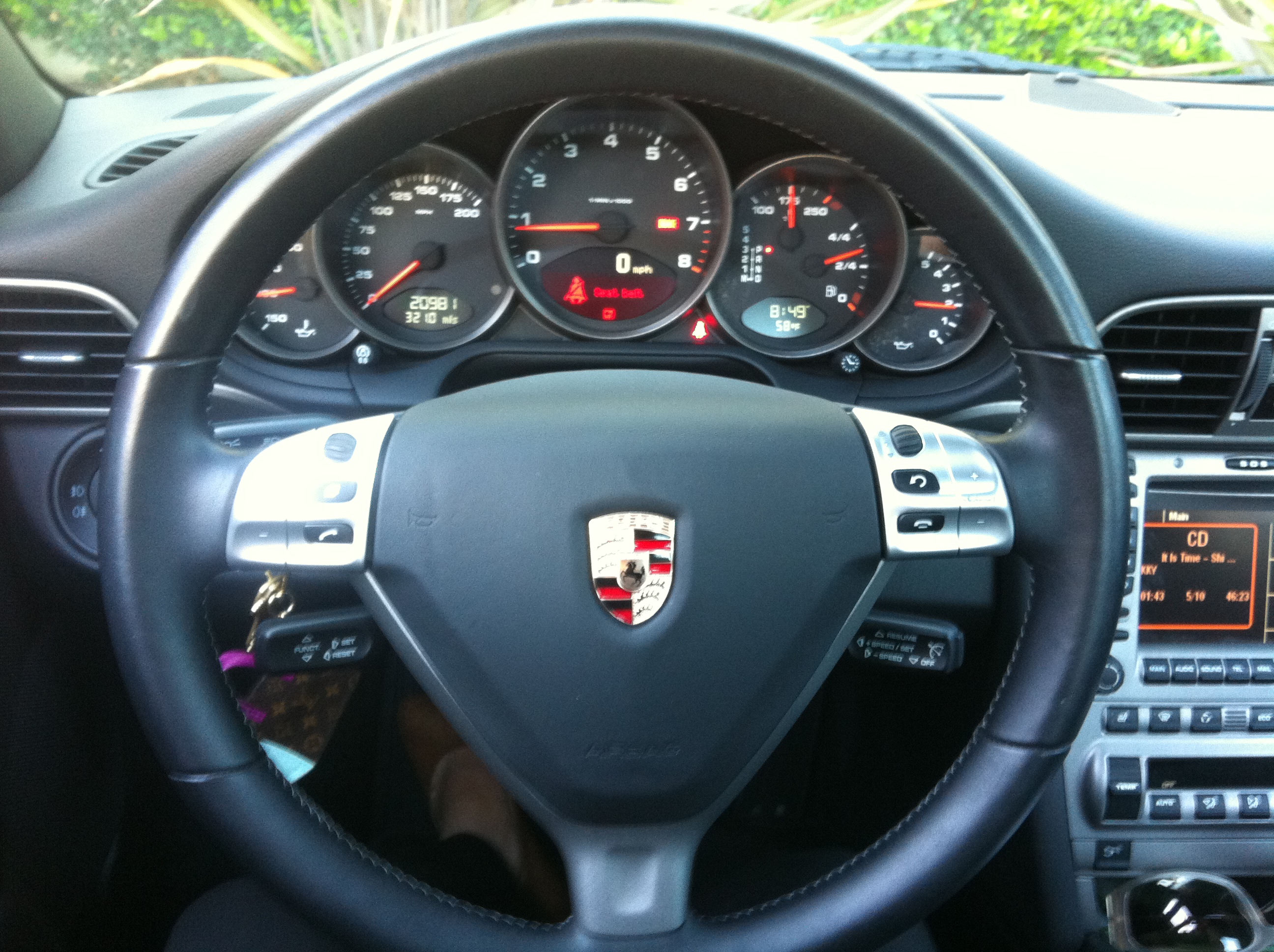

  3. Found a used 2007 Carrera on my local CL with 22,000 miles. Seller says it comes with CPO warranty that is transferable to new buyer. Lapis Blue, Tiptronic, Bose, Leather, and not much more above standard kit. 2nd owner only had it for 6 months and less than 4,000 miles but is moving so needs to sell. Its in pretty good condition - just a bit dirty and she did not service it while she had it since it was only 4,000 miles. I am wondering if $44k is a good price for it. She says she got it for $48k from the dealer in November and same dealer is offering her $44k for it now. Seems like its good deal. I took it for test drive and it seems to be in order (except for a bit dirty and paint has some minor imperfections and chips and strangely she never got license plates for the car). Anything I should do before buying besides pre-purchase inspection? She didn't have the previous service records, can you get those from the dealership? Thanks in advance.
