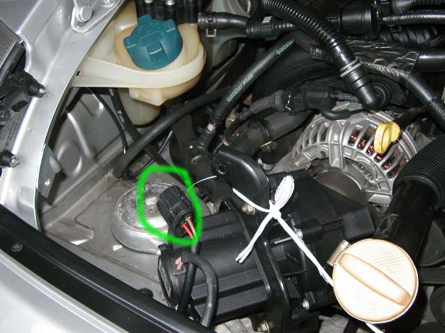

  20. I see there is a socket (plug) in the air pump but it is apparently not connected to anything. What is the purpose of this? does anyone know? just curious . See the attached pic for the detail.
