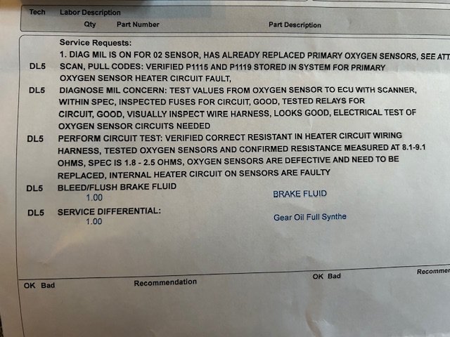

  1. Thanks to both of you. A brief recap of my saga- June- CEL comes on with 1102 & 1107 codes. I buy 2 new Bosch sensors and install them ( pre cat ). CEL out for about 75 miles and comes back on with 1115 & 1119 codes. Same problem with a different code # this time. Remove and clean MAF sensor. No chage in CEL or codes. Decide at this point I need help and take to my indy shop. Here's their conclusion- I am dubious that both new sensors could be bad, but go ahead and buy 2 more and replace them. I got about 200 miles of no CEL before it came back on, with the 1102 & 1107 codes...Not happy having spent over $500 on diagnostics which were incorrect apparently. The receipt seems to indicate the harness has been ruled out, but I don't know if they did a wire by wire check as Jeff has suggested and should try and confirm that. Not sure what to do at this point. I guess I am intimidated by both the logistics of the harness check, and fear of harming a wire at the connector end trying to check it myself. Since it is consistently both banks and the same 2 sensors, it has to be something in the electronics upstream of the senors right?
