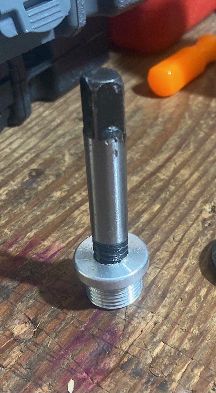

  1. Thank you for the tip to cut the tip off the #5 5 screw extractor and work it in slowly. Worked like a charm, especially when coupled with my pipe wrench to break the over torque I put on the plu…. I had started drilling a hole in the plug to get the full tool in there but thought better of that plan when it seemed extractor was just drilling a bigger hole in plug and went with yours plan.
