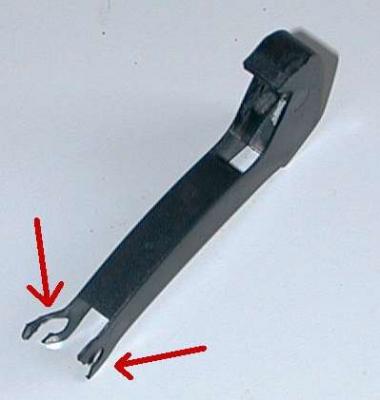

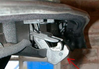

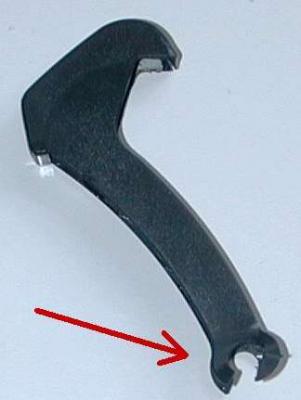

  1. My bet is the platstic hook has broken off the hook that attaches to the screen. All you need to do is glue it back on with some contact adhesive and all will be fine. The arrow in the 2nd pic shows where it breaks. Don;t worry about this, just glue it back on without taking the whole unit apart. Simply just pull it off. The 1st pic shows the plastic hook part separated from the metal hook part it covers. Once glued back all will be fine again.
