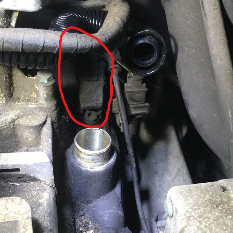

  1. Here is a pic of the passenger side with the sensor removed. The sensor is located on the passenger side at the rear corner of the engine and is difficult to access. I had no codes but decided to replace both hall sensors while I had an easy opportunity to do so. I have already removed the entire top end so removal was very easy. Use a 5mm hex socket with a 1/4" ratchet. Just be careful of the 5mm hex bolt and do not strip it and go at it from the correct angle. I almost stripped the inside of the hex bolt because I was going at it at a 180 degree angle. I replaced the bolt with a new one as the hex was a little mangled. The sensor is located under a bunch of wires. Press down on the clip and disconnect the connector after the bolt is removed and the sensor is loose. Trust me, much easier this way rather than breaking the connector. There just is not enough room to get a good grip and torque on the connector with both hands. The PS high pressure line hose and the PS support bracket it attaches to can get it the way so try to remove the bracket. Of course, the only way to get at this is to remove the large coolant hose at a minimum. Don't forget to replace the O-ring with a new one. Wipe down and clean up the area in general. Use blue Loctite and torque to 7.5 ft/lbs. Pic of the sensor location with O-ring:

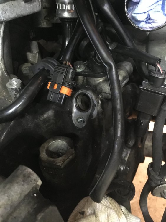

  2. OK I figured this one out. The hall or camshaft position sensor has 2 locations on the 1999 C4. The one I was having trouble locating is located right next to the AOS. So if you have removed your AOS, now is a good time to replace the sensor. It is located on the drivers side to the left of the bottom AOS bellows metal tube. If you follow the long AOS breather tube as shown in the picture, you will find it. Just simultaneously push down on the tab and up to disconnect the electrical connector. Then use a 5mm hex to remove the bolt with a socket and then pull the sensor out. If you have removed your AOS, this can be done from above the engine. You will need a 5mm hex head and 1/4" ratchet with a 10" or so extension. You will have to remove the entire thing blindly using your right hand. Or it can also be done from underneath the car if it is jacked up and the AOS is removed. Attached pic is rear of engine on driver side. Looking from the passenger side to the driver side. Part number is 996-606-106-02 and is the same for both sides. Bosch is the original OEM part and much cheaper than Porsche labeled part. Make sure to buy new O-rings 999-707-404-40 and new bolts 999-218-005-01.
