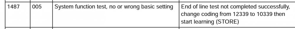

  1. update, I have gone into Developer mode E. Now i see a text field labelled "Coding" with a value of 0B28B1. Here I can't input the 10339 value, because it states that the field must be 3 digits only. So stuck again 😞
  2. I feel like a dumbdumb.... Went through all the pages again, can't see anywhere to input numbers, besides the wheel ID page.. Do you know what exactly this is about?
  3. Anyone knows how to correct this error?
  4. Could it be that I need to place it in developer mode to find it? Tried, but did see any obvious places to enter that coding number... 😞
  5. On the first page "Overview" I select Tire Pressure Monitoring System. Then it takes me to the identification page which lists module found and I select that. After that it is in the TPMS section where I select tabs: Fault codes, live values, Drive links check, coding adaptation maintenance repairs and programming. Under coding adaptations it only says General coding and in there i can do "System ON" which is on currently, or i can change instrument cluster type.. Under Programming tab I have nothing and it says "No programming rules are available".
  6. Hi Danny, Thanks for your quick reply. I'm a beginner with the Piwis, just got it today, so I have no clue on where this "Change coding" from something to something else is located. I believe that i have been through all the pages and functions, but have not seen any such option as they instruct me to do. Would you be able to point me in a direction?
