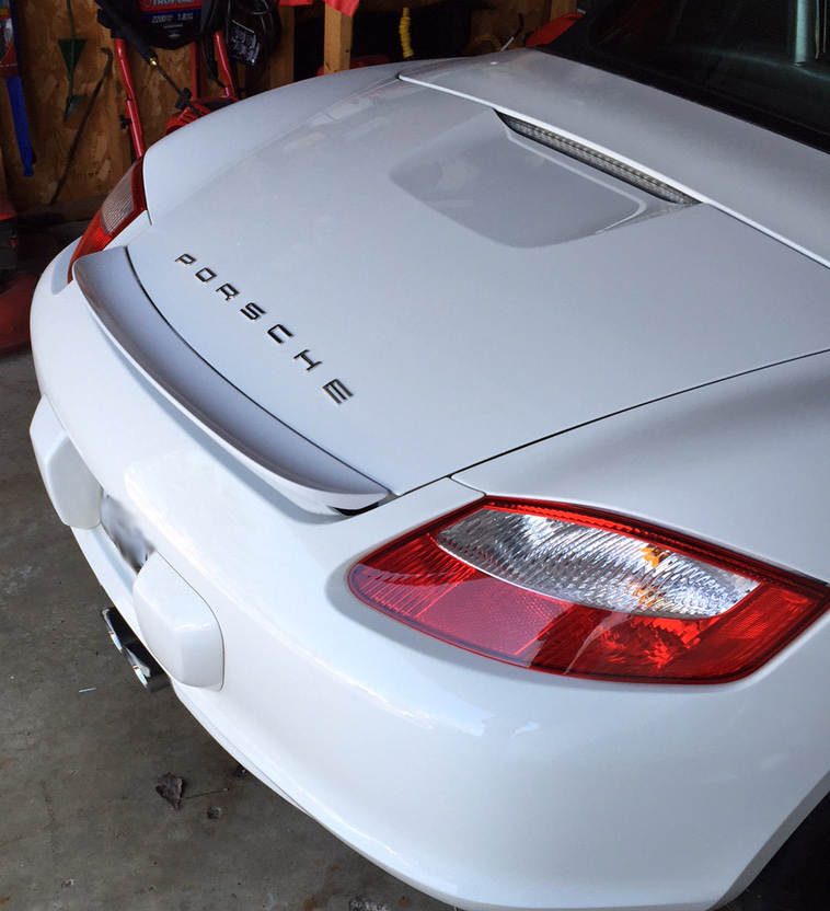

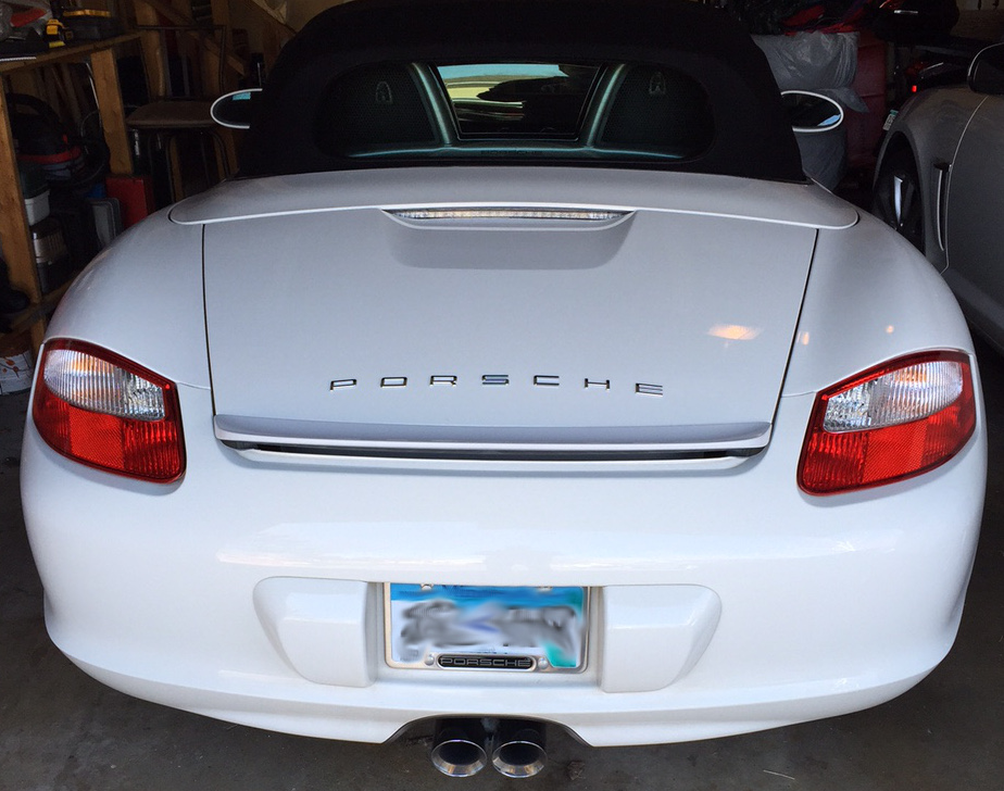

  1. Hey just wanted to know if there Oval HD screws for the Caymen to Boxster spoiler conversation were from the Boxster or ordered new because I can't find the PN you listed anywhere to order. Thanks.
  2. I ordered all the parts for doing the Conversion from Porsche, and it was a relatively easy job. 1. Order Parts: • Cayman spoiler (lower): 987 504 623 00 • Cayman spoiler (upper): 987 504 619 00 • Oval HD screw (Qty: 7): 999 919 233 07 2. Prime, Base coat and Seal the upper spoiler 3. Remove old Spoiler 4. Install new spoiler
