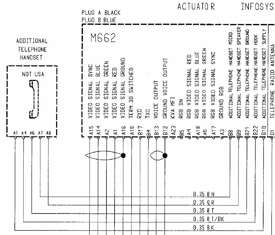

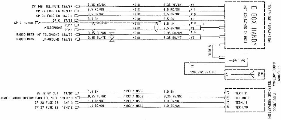

  3. I'm confused... Do you have the option numbers? Do you have the cell prep? or the cell phone option (installed)? ... and US or RoW car?

  10. The schematics show all options for all countries so chances are the wiring harness in a US car does not have the wiring.
