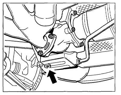

Does anyone have a diagram showing where the turbo drain plugs are located? Any help would be appreciated.
Thanks,
Jim
Jim,
The oil drain plugs on the turbos are on each side of the engine. Here is the picture on one side of the engine:
Vijay
  vjrp63 said:
Jim,
Vijay
Thanks Vijay -
Jim

  vjrp63 said:
Jim,
Vijay
Also note that the torque spec for these are 22 Ft/Lb.
-Arman
