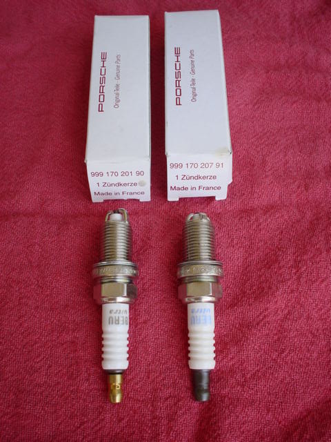

If you want to use the oem plugs you do not have to buy them from Porsche. The Beru for the 2.5 is 14FR7LDU, and for the 2.7/3.2 it is 14FGR6KQU. The Bosch for the 2.5 is FR7LDC4, and for the 2.7/3.2 it is FGR6KQC.
The box and plug on the left is for a 2.5 and on the right for a 2.7/3.2. These happen to be Beru plugs. Porsche only has 2 part numbers, for the 2.5 and for the 3.2. There is no separate part numbers for Bosch or Beru. You get whatever brand is in the box, but all the replacement plugs purchased from Porsche I have seen were Beru. My 2.5 came with Bosch and I replaced them with Beru at 30k miles, and noticed no difference between brands other than one is made in Germany and the other in France.
