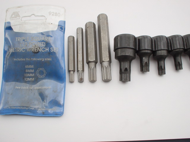

Now that I think about it, Peter used a triple square bit to get out a drain bolt, not a torx bit. He showed me the plug with the bit still stuck in, because I asked him how he gets out an aluminum plug when the recess is rounded. It was not a plug from a Boxster/996 but some other Porsche aluminum plug. I even asked him about welding a nut onto the plug, but the problem is is the oil drain plug is aluminum.
As long as you can get some tool into the recess that will not spin under torque.

I'd go with TP's recommendation: Best thing is to sharpen a triple square (sharper edges than a torx) and hammer it in. Make sure the engine is warm before you do it. Because of the different thermal expansion coefficients, the alumin(i)um engine will expand more than the steel plug and the plug will be easier to get out.

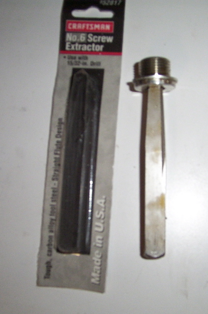

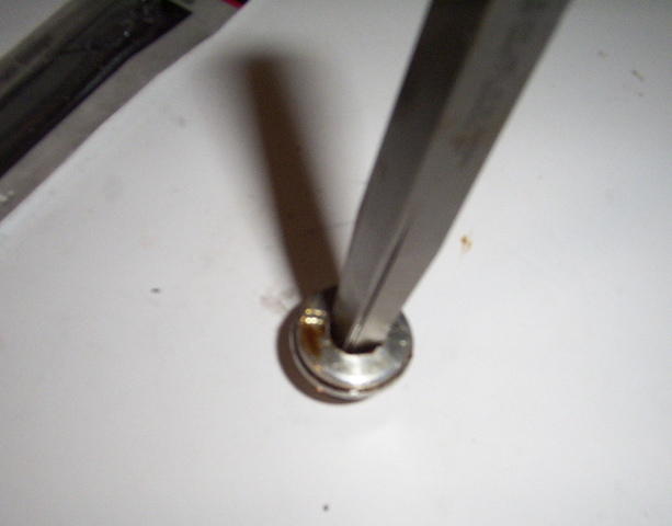

The easy out worked great. I hammered that S.O.B. in nice and tight and attached an adjustsable wrench and used a breaker bar....VOILA! Oil change complete.
Video to follow..............

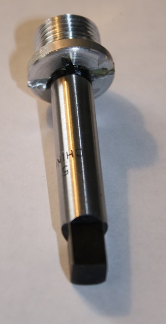

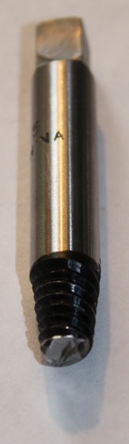

I had the same problem, I was able to get the bolt out using a black & decker screw extractor set, I had to cut the tip off the #5 bit in order to get it to grab. the bit was too long otherwise... It worked flawlessly and required no drilling or hammering...

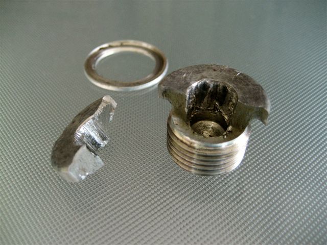

These photos are of my oil drain plug from my Boxster 987, I replaced the drain plug with a drain plug from Pelican Parts, it was listed as a drain plug for 986 but it worked fine.

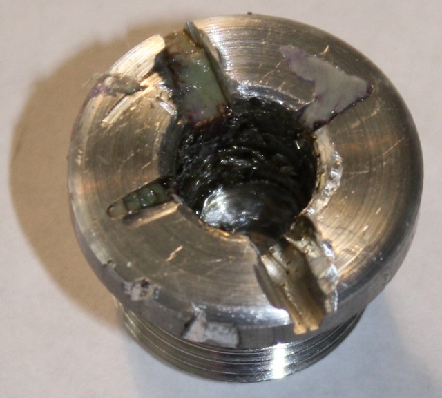

Use some caution when dealing with a stripped drain plug as they are made of some pretty soft metal.
I was just finishing up an oil change and when I attempted to torque the bolt its head split. This happened before I was near the torque specs.
With half the bolt head broken off it makes getting the remainder off a little tricky. :)

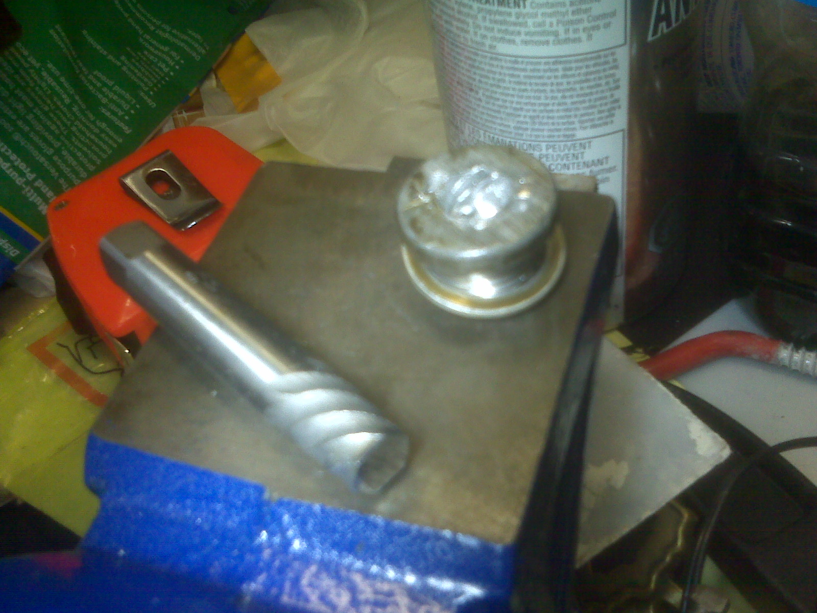

Thanks for the write-up. I had fixed mine on the weekend with a cut down #5 screw extractor.

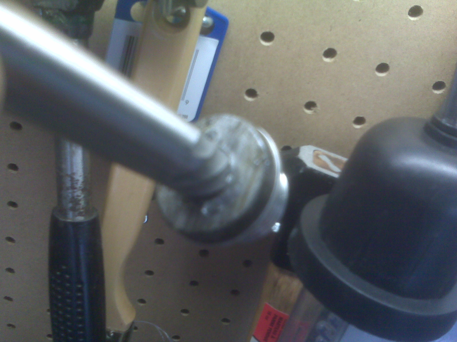

I know this is an old thread, but this finally happened to me. For others that might see this, to keep the extractor in place (after beating it with a sledge {not recommended}), i used a floor jack and a block of wood to apply pressure and keep it in place as I turned it with my cresent wrench. What a nightmare! Had I resorted to the jack earlier in the process, it might have saved the engine some abuse... Good luck.

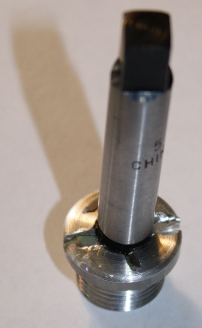

  On 11/13/2004 at 2:15 AM, LVDell said:
Here is a picture of the screw extractor hammered into the drain plug that was stripped.
