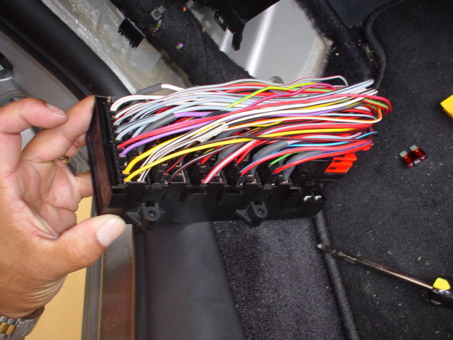

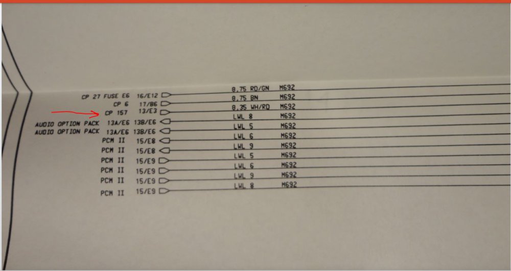

It is the fuse box next to your left foot. Pull the cover off then you remove some screws and pull it away to get to the back. Lots of wires back there. Raman followed the TSB issued by Porsche.
Hiya ToolPants...I took out the fuse and looked at it...HAHAHAHAHA...I should have known!
Anyway, according to the TSB that I have, because Porsche doesn't provide instructions for the retrofit, I am to pull fuse block "E".
Establish power supply to E6/Term 30.
Remove fuse E6 from carrier.
Press out Rd/GN wire.
Bundle RD/GN wires from retro kit with RD/GN wires from vehicle side.
And replace E6 back into the fuse box.
Is this what you guy's did?
Thanks again.

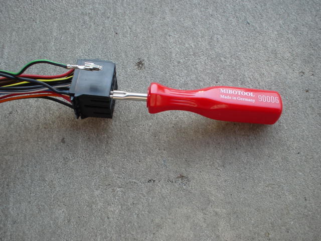

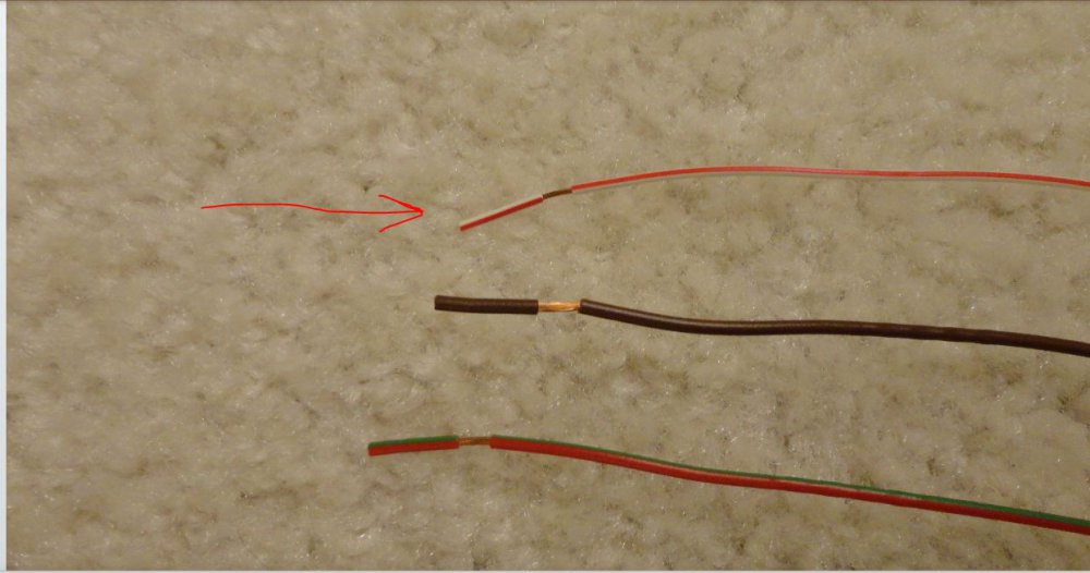

We did not have the pin removal tool to remove that wire. We tried small jewlers screwdrivers and stll could not get the pin out. So the 2 wires were combined with a small wire tap. That is what I remember because Raman asked if I had wire taps and I had a can of them.

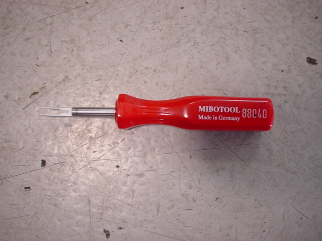

P.S. There are 3 pin removal tools mentioned in the TSB. 88040 is to remove the wire from the back of the fuse box. Since we did not have it a wire tap was used instead. The TSB says to remove 2 wires from the radio connectors with the other 2 pin removal tools. Since we did not have them either 2 more wire taps were used.

I was not watching Raman all the time as I was working on another car. He figured out what wire to tap into by looking at the instructions. The pin locations are numbered and you can also verify the wire because it is red with a green stripe. You are combining 2 wires with the same color code. In Raman's case with a wire tap.

It seems that the best and easiest way to go is to use wire taps. Takes about one minute per wire as long as your fingers are nimble. It was nice to hear the CDC-4 wind up.....Now I have to get it programed...BUMMER!

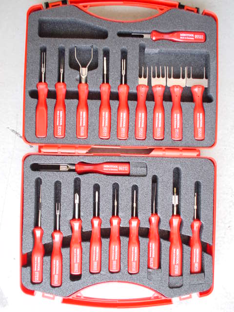

For other brave souls, this is the 20 piece pin removal tool kit mentioned in the TSB. Every time I touch the kit Peter does a count to make sure they are all back in place.

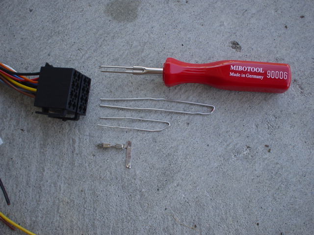

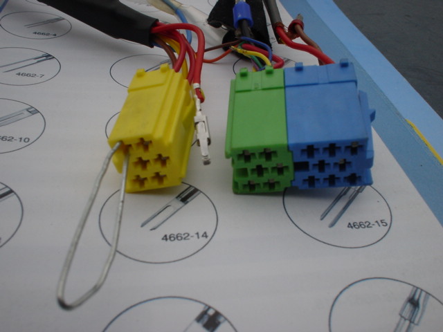

i did the retrofit on my '03 coupe last month. at the same time i added the PCM2 nav unit. i too did not have any of the pin remover tools mentioned in the TSB but just used a paper clip unfolded. you just need to push something down the holes on either side of the pins and that does the same function as the fancy tools.
of course, if i were to do alot of stuff that would require the tools, i'd probably end up buying the set :D

Believe it or not, we had no paper clips last summer. Just my set of jewlers screwdrivers which were too big.
I now carry in my car for our work on cars days an official set of paper clips due to last summer. And a can of wire taps. :P
