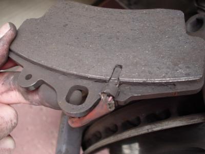

The sensor is a simple loop of wire covered by black plastic. When the friction material becomes thinner and the pads move towards the rotor the rotor grinds away at the wire until you have an open circuit and the light goes on. Some say that if a sensor is worn and gets wet the light will go on.

This is the sensor.

Took a look at the brakes today while replacing the spark plugs... Although I continue to get an off and on (mostly on) brake wear light, the pad thickness looks OK all around. Compared to Tool Pants picture above I have about 2x as much pad left (textar). The 'pad' side is definitely thicker than the 'base' side.

Porsche says 2 mm but I think your wear sensors will trigger before that.
Did you check the inboard pads too? This can be hard to do unless you remove the wheel. Each of the 8 pads on a Boxster has a wear sensor.

Yes, I'm looking at 6 to 7mm all the way around. Next step is to check continuity of the sensor connector and wires... Brake Wear light is still intermittent.
