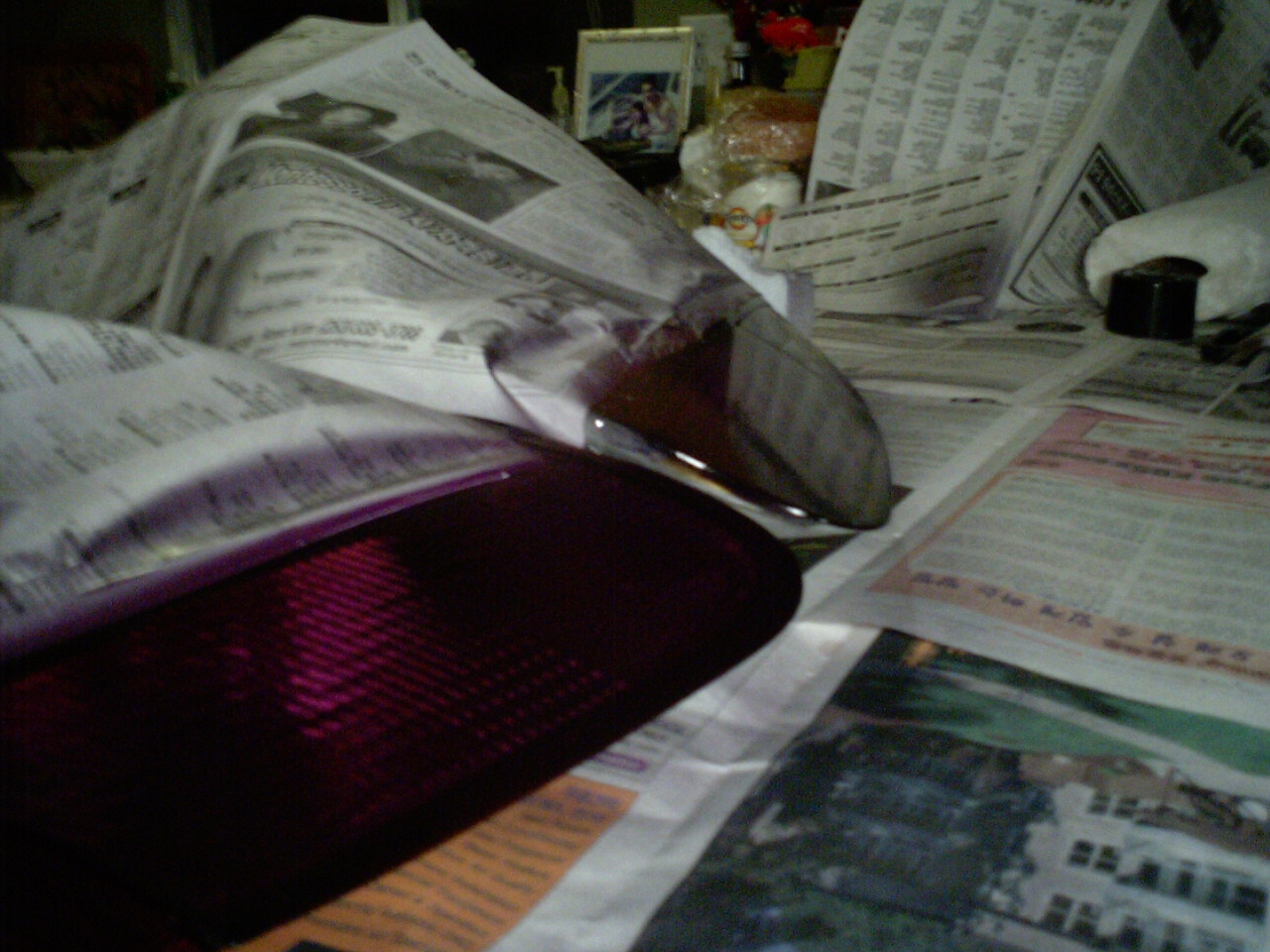

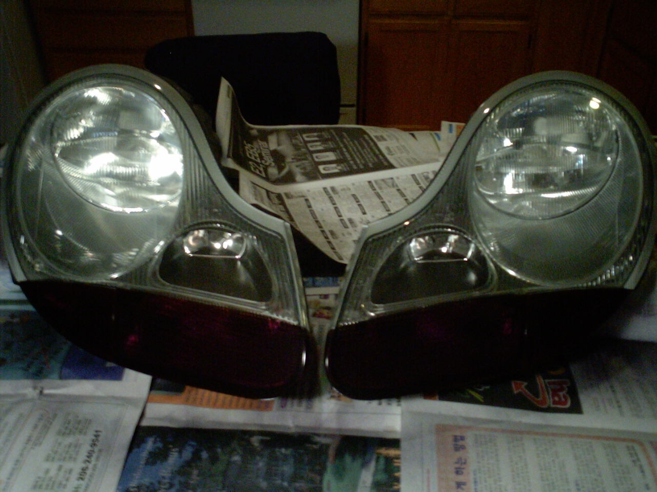

Since coffeesucker & litq asked about those black tail lights. Why not post a few pix-I thought.
Recently I was debating to upgrade my head lights but they were a little too spendy! plus I 've already spent some time modifying it to xenon.
So I deambered my clear wanna be headlights,,,since I haven't gotten the tails yet. LOL

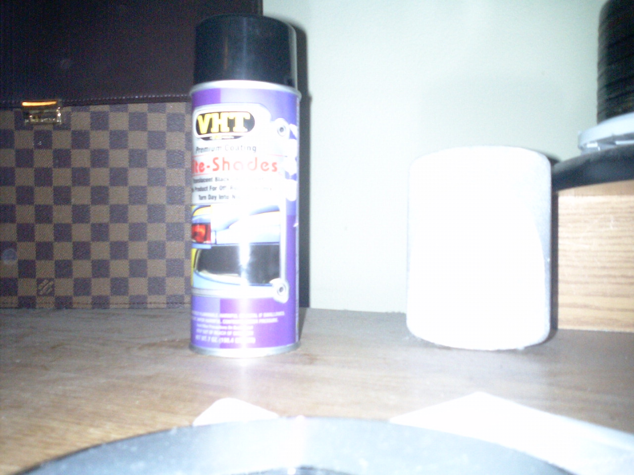

Oh boi this stuff is hard to get post-23680-1197019265_thumb.jpg I must have called 20 diff local stores.
post-23680-1197019329_thumb.jpg before
post-23680-1197019451_thumb.jpgafter
post-23680-1197019578_thumb.jpgpretty glossy,don't u think?
post-23680-1197019653_thumb.jpgthey r about done I think

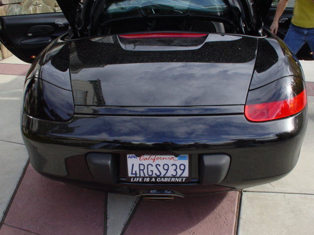

2 versions of black tinted tail lights on a non metalic black car.
I don't want too seem too anal, but I thought I'd comment on the black tail lights again... I had looked into this before and checked the California code on tail light regulations. They require that your tail light have a red reflective portion that can be seen at night by another car's headlights from 300 feet away. The tail lights on the left that Tool Pants showed a picture of would not pass code, but the tail lights on the right would be okay. Covering the amber is no problem as long as it still shines through amber when you signal. I would check your local state regulations. Again, I would worry less about harassment by the police and more about liability in an accident though. If rear-ended, this may shift some fault from the person who hit you to you. Even though the lights still shine through red, the light level is lower than standard. If this is found to have contributed to the accident, well then you're screwed.
As for the Nightshades spray... I could not find that stuff anywhere around where I lived or on the Internet. I wanted to paint over the amber on my headlights like Juniinc did. I ended up bying some model shop smoked tint spray for plastic models. This was relatively easy to find at a local hobby shop. I still haven't painted my lights yet though, just been working on other things. However, others have reported good results with this stuff - similar or the same as Nightshades.
Edited by Bristol
Neither of those lights are technically legal because the do not have DOT on them, with or without the tint. They are euro amber lights that were tinted in Germany.
Henry had a bunch of lights and we tried them on Aileen's black Boxster a few years ago. To make the bulbs brighter Henry came up with the idea of replacing the single filament bulbs with dual filament bulbs.
Another test picture.
nice photos to compare TP. I guess technology has developed over the past few years.

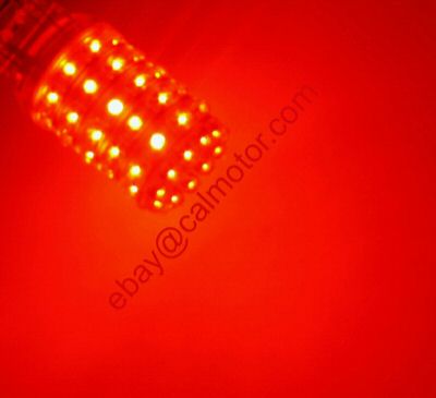

If u want to make the bulbs brighter consider using these LED's PPL-
Direct replacement for 7506
Yes nite shades r hard to find, not many ppl even knows about it. hey Bristol if u r in the US ,let me know ur zip. I can tell u where to buy in your local area.
