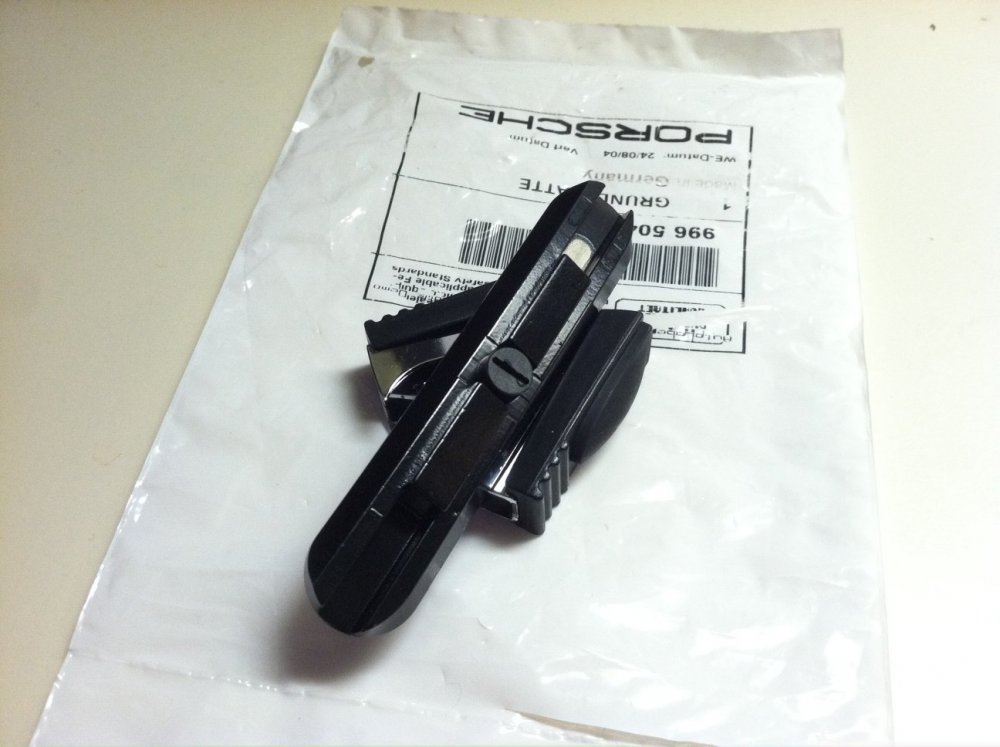

This thread is a great resource for anyone that has been frustrated by Porsche's lack of forethought in this matter. I just ordered a couple plates from Sunset Imports in OR and they were not too expensive ($24.86 ea). I attached a couple pics. At this point, I just need to schedule the installation on a free weekend to get them in.
post-9516-0-51352300-1311252979_thumb.jp
post-9516-0-81816200-1311252988_thumb.jp
Here is a copy of the invoice. Note I also ordered extra washers and the threaded bushings that come in contact with the plate just in case.
post-9516-0-80476700-1311254031_thumb.jp
Edited by auto-xr
