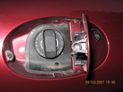

Here's my fuel filler; the vent is at the top right and drain hole at bottom center. Revved to about 2500 rpm the vent definitley whistles (darn near loudly) due to blowing or sucking air (sorry about mising this detail, I was so excited when I finally ID'd the source of the noise I didn't stop to make that note). When whistling, if you cover the vent it stops. Also, as noted in the earlier post on this if you change engine speed it will stop. I think it's part of the evap purge system. Also, my mpg seems to have fallen off considerably.

I'm not inquiring abou the drain hole in the center lower portion of the filler (see pic), but the other hole, which I beleive is a vent, at the top left.
