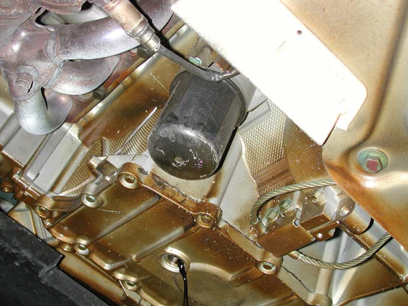

I put the car on jack stands. Everything was readily visible and easily accessible. I was surprised at how fast and the force with which the oil came out, once the plug was removed. I was using one of the "jerry" style plastic cans with the catch tray on the side. It didn't work. I ended up with a lot of oil on the floor. Next time I will get a bucket that holds enough oil.

Once you have the right tools (for the oil filter plug, for the oil filter housing and a torque wrench), it's as easy as any other car, and actually a lot easier than some cars I have done where it is exceptionally difficult to access the oil filter.
Follow the directions in that DIY link and you will not have any surprises.
The caution that David gave you about the oil coming out fast and furious and splashing is one that you should definitely heed, because it will surprise you. It surprised me the first time I did it, and I have changed the oil and filter on other cars more than 100 times.

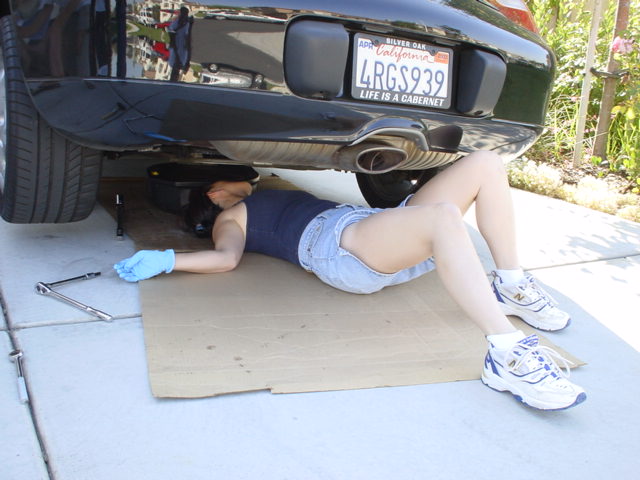

At our work on cars days we usually get the women to change the oil....

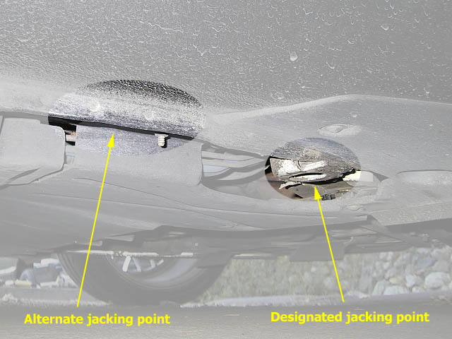

BTW, I gave it a try today... Jacked the car up through the alternative jack point (pic below) on the left side, but as I raised the jack to get enough clearance to put the stands, the jack felt very unstable (pulling towards the car!) Is this normal? Well, I didnt think so... So I had the beers and came back in!
Is my jack too short for my stands, or is the load capacity too low? Could it be the surface of my garage? This is my jack Craftsman 2-1/2 Ton Floor Jack, Low Profile and these are my stands Craftsman 2-1/4 ton Jack Stands....

Yes perfectly normal (the lifting arm is not variable in length so the higher you go, the closer the base needs to get to the vehicle). This is the main reason it's on wheels too. Otherwise as it lifted, it'd try and pull the car towards the jack - not good if the other side were up on stands, huh? B)
Jacks are always "upredictable" and a little unstable - thus why you should never ever ever work under a car unless it's supported by stands. As an extra safety precaution (when pulling wheels) is to lay them on their side underneath the rails.
