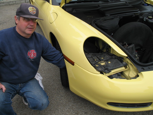

It will depend on the size of your hand - some folks can reach up from underneath and grab it and some folks take one of the plastic rivets out to slip their hand in (that would be me).

Like this in a LHD USA car. My fingers are on the loop on the end of the cable.
The wheels were not straight ahead. The head light had been removed. It will not be this easy for you. You will be working blind and the cable is not always where it should be.

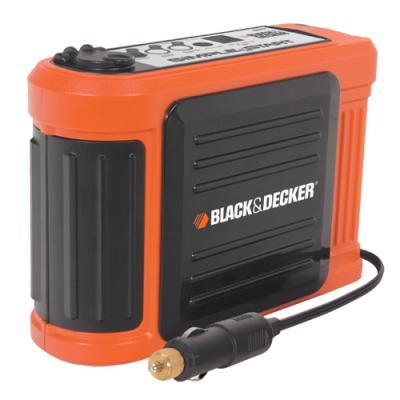

The easiest way to do this is to go to the store and buy this which plugs into your lighter.
Black and Decker Simple Start Vehicle Battery Booster
Model #:BB7B
# Vehicle battery booster plugs directly into vehicle’s DC outlet
# No jumper cables required, charges & starts vehicle in minutes
