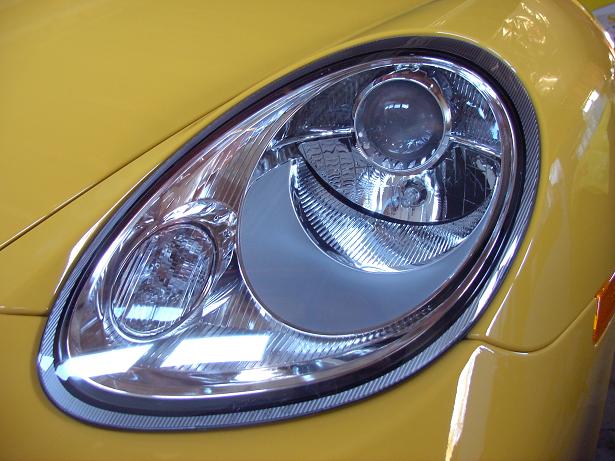

So Alan, your car has the same style of headlight assembly as I show in the picture right? The lights are too bright to tell! :D
Does the kit you installed use the usual 35W HID bulb (I know there are many, but nothing unusual?)?
As I posted, I am bit worried about the danger of damaging the headlight enclosure.

All HID's are 35w. They won't damage the housing as the original headlamps run a lot hotter than a Hid lamp ever will. The projector will give you a really nice cut off as well should would out pretty well i would say.

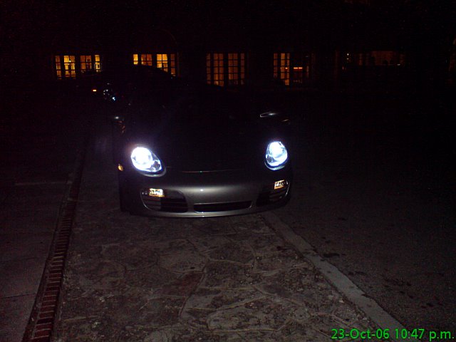

They should be here any day now (in time for Christmas!), ordered 5000k models from CQ Light, For those interested I'll post my installation and results here.
Great!, I haven't even received them and they have dropped $20 in price! <_<
Now on $179.99 for the kit...
Also I see they are offering 'digital ballasts', maybe (as usual) I should have waited!?

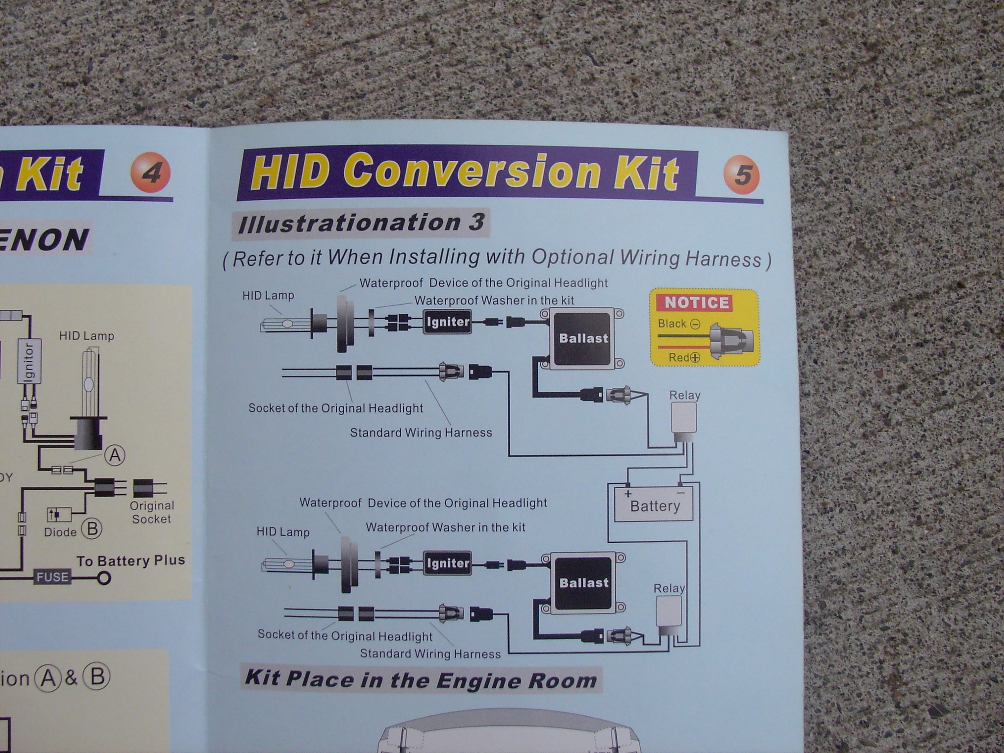

They said " install the optional harness", this powers the kit through a relay directly from the battery... investigating
Here is a picture of the optional relay harness:
Edited by Westcoaster
:lol: :lol: :lol: a bit off topic here but I did get a chuckle out of the instructions pic with the word "Illustrationation".
I think something got lost in the translation...
Thats what I am starting to feel like... "Illustranted" !!!
