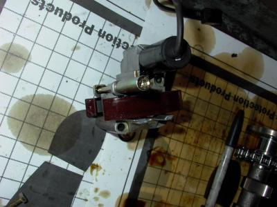

i got a photo to upload.. maybe I think this is the wrong part :oops:
if i am wrong.. where is the cam sesnor :cursing:

Yes, you do have the wrong part. The cam position sensor is on the head itself (you are pointing at the valve cover), on top, almost directly above the part you are looking at. I'll try to dig up a picture when I get home this evening. Manwhile, anone else who wants to chime in (1999Porsche911) please feel free.
So is that part with the wire coming out of it the Cam actuator? I replaced the gasket around it (even though it still leaks a little, that picture was taken before I replaced the part)

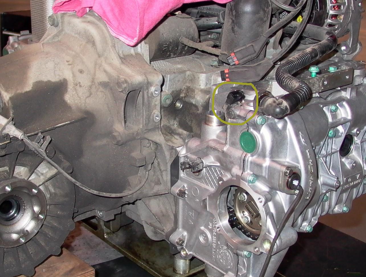

Yes, I believe that is the variocam actuator. Here is the cam position sensor:post-34-1161652233_thumb.jpg
