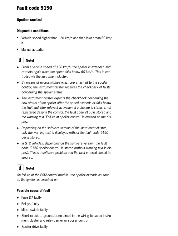

hey guys just got my new to me 2001 black on black 996 tt with 19k miles on it. but for some reason my spoiler won't move at all. You push the button on the dash and you get the dreaded light. Tried listening for any hydraulic pump whine (like its trying to lift it) and hear nothing. It doesn't seem like its leaking or corroded. My durametric tool came up with 9150 spoiler control status: present. Not sure what that means but any help will be greatly appreciated. Also my key remote is not working, I know this is a common problem but i've tried everything (turning battery around trick, trying new battery etc.) light on remote works fine and if i lock the car with the key I can turn on the alarm system. So I am confused. I await patiently for your response.

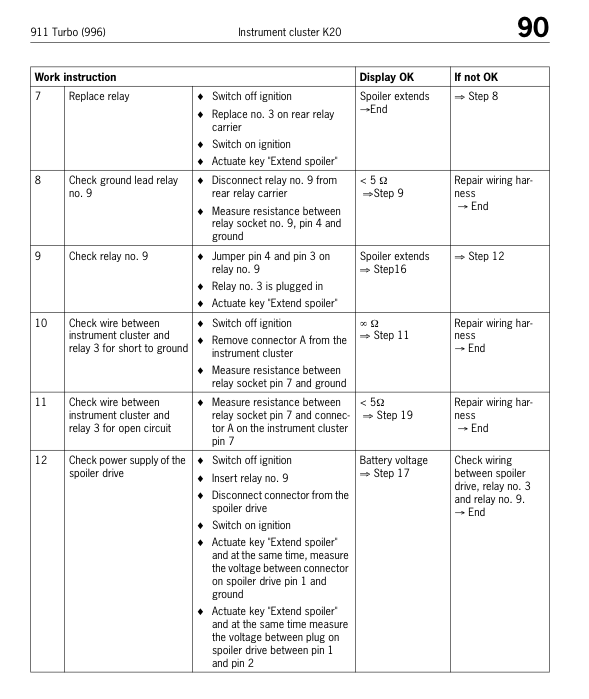

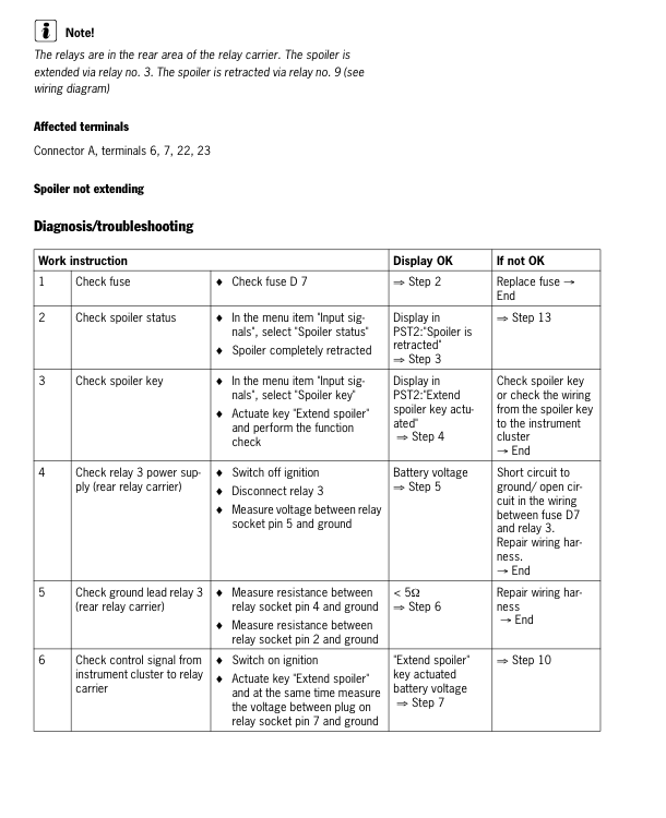

First look at fuse D7 and after start the troubleshooting as required ....

thanks for reply. the fuse is fine, looking at step 2 and i dont know what pst2 is. I assume its a porsche diagnostic tool. I just got a durametric tool but not sure how to check if it has this ability , anybody know out there. please respond soon thanks

jpflip yes i did reset the codes but if i hit the dash button it just comes back. funny that it doesn't notice there is a problem unless you try to run it. i guess the computer doesn't check that its operable on start up like it does with airbags, abs, traction control etc. or it does and the spoiler is just stuck (from lack of use) car only has 19k on it and i am not sure even the last time it was drivin (bought at auction).

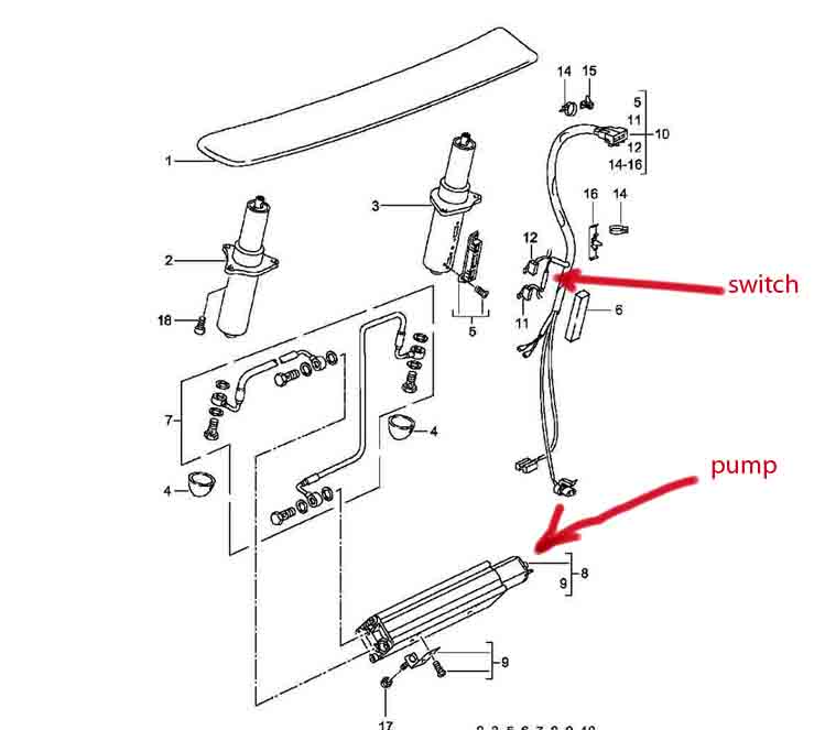

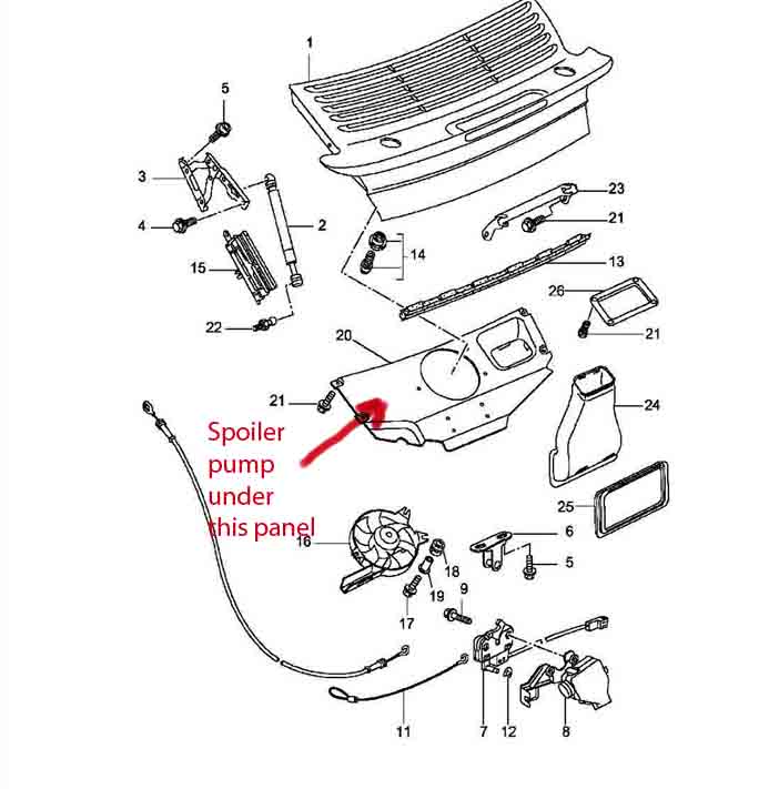

Your right it doesn't test it . And if there is a fault it will only show the fault light when you reach 120 km/hr. If you got access to a voltmeter you should check if you got voltage going to the pump. The pump can be reach wit the removal of the panel under the engine compartment. Also check the switch on the right hand actuator under the small plastic cap to see if they are not out of position
