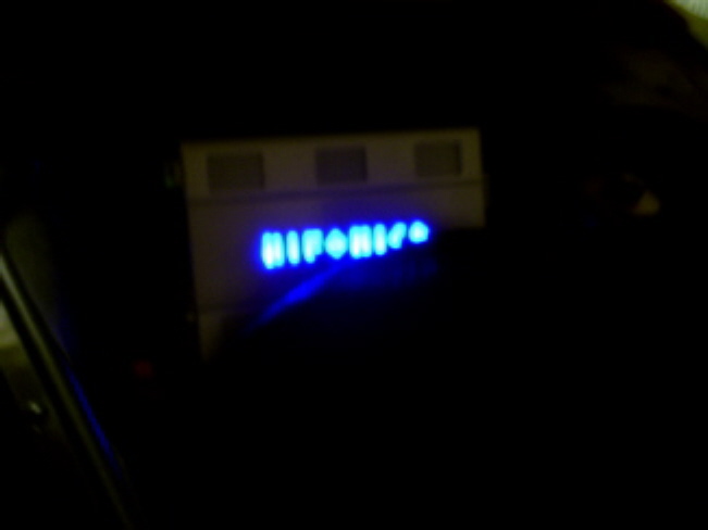

I have a 99 C2 with the same factory audio (M490) and I just installed an Alpine iDA- X200. I decided to get rid of the factory amp and got an after market
5-channel amp. The problem is that the 6-channel factory amp has some non-standard input level and a built-in crossover for the sub (in the doors)
that can't be modified.
If you don't want to go all-out on speakers and amps, I suggest to put 6x9 speakers in the doors (they fit nicely once you remove the factory speakers
and enclosure) and connect them directly to the X200.
I ran 6x9's in the doors for about a year (with a cheap 2x100W RMS amp), I just upgraded everything, Polk Audio DB401 speakers in the dash and a custom 2x8" sub in the back driven by a used Hifonics Z700 5-ch amp. I'll install the PXA-H100 Imprint audio processor this coming weekend.
