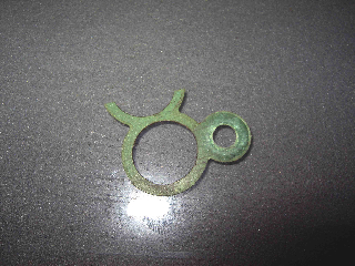

the gasket broke but its still around, it was very brittle, I'll take a photo, note sure of the part number but as I ordered one the invoice may have a part number on it. I used black gasket silicone in place of the original.

heres the broken one, you can imagine the bit missing by looking at the icv in the instructions
part number thats on order (from the invoice) 99611031050
