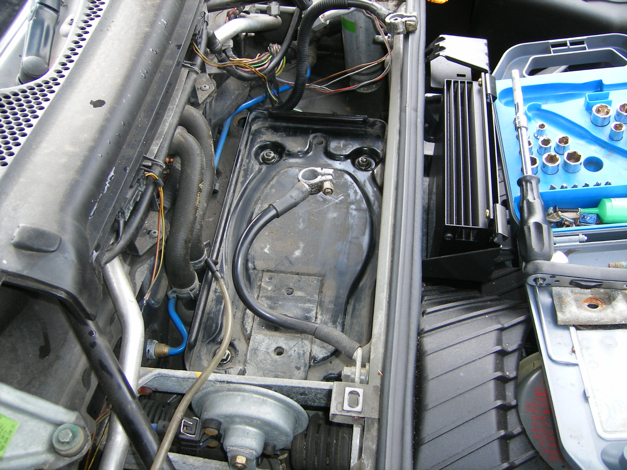

When you open the front boot, the compartment where the battery is, I have found about 5 litres of water there, as there are two holes/tubes/drains, which were totally blocked.
Now, I have unblocked them, but one of them (the one on the passenger side) I have pushed a bit too hard and pushed it in out of the hole.
Does anybody know if this will make a leak into the car as well?

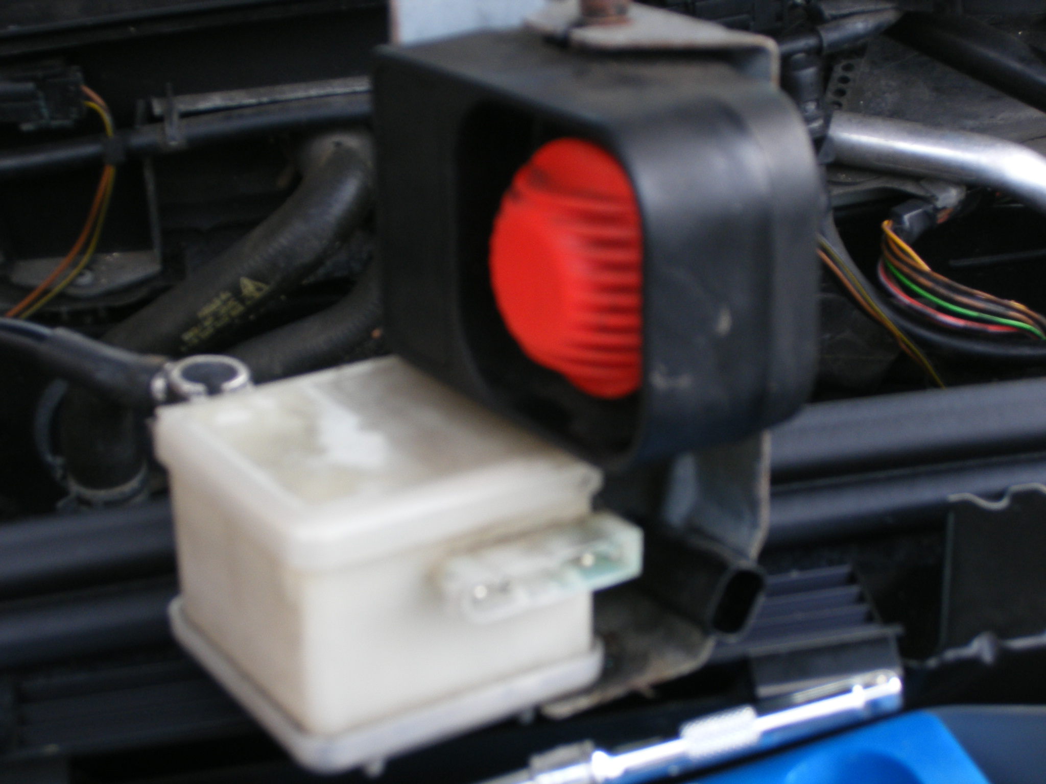

How I have found out about this, the water got into the alarm siren and now it's short cutting and making funny noises :(
I hope that it will fix it self when it gets dry.
No worry this make no leak into the car, but the alarm siren ( and if the car is equipped with a lift sensor - white box ) is/are faulty. There is a good chance that the brake booster contains water, this give you in the future problems with the brakes ( stick ). Pour out the booster A.S.A.P.
Ok took it all apart and have a few questions...
Brake booster - is it the part located under the battery plate? Looked all dry there, but I didn't open that as it seamed sealed.
Lift sensor - the white box was under the water and the siren was making some funny noises (short-cuts due to the water), stopped now, but there seams to be some water inside the white box - good or bad????????
Now each time the car is locked, we get the double bleep as something is open, but all is closed :(

The brake booster is located under the black plastic cover, the master brake cylinder is bolted on it.
The lift sensor is faulty and is the reason for the two bleeps. ( TWO bleeps = ALARM system fault --- ONE bleep = something not closed )

You cant open the booster, all you can do is remove the booster pour out and let him dry. This gives you no guaranty for the future replace is the best option. Brakes are a safety item, two hands are not enough, if you got no experience with brake systems go to a workshop.
Just an update, the the alarm stoped bleeping 2x, but it works as we have tested on the open compartment and it bleeps 1x :)
